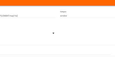

You have a colon “:” too much in your item definition.
1#STATE not 1:state

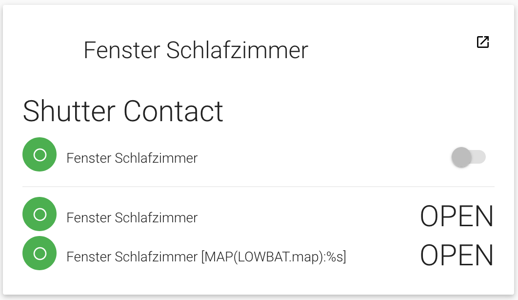

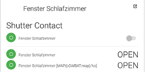

So your .things file for homematic only has the Thing, Type, Serial, Name and maybe a location?
Thing HG-HM-Sec-SC-2 SERIALNUMBER "Türschloss" @ "Flur"
And then your .items file has all the Items with channels?
Contact itmAlarm "Türschloss [MAP(windowcontact.map):%s]" <alarm> {channel="homematic:HG-HM-Sec-SC-2:default:SERIALNUMBER:1#STATE"}
Contact itmAlarm_BAT "Türschloss [MAP(LOWBAT.map):%s]" <battery> (Flur) {channel="homematic:HG-HM-Sec-SC-2:default:SERIALNUMBER:1#LOWBAT"}
Maybe i´ll try to remove every Thing from the Paper UI or directly from the jsondb and have a look on the .things again.

The #LOWBAT channel is a Switch, not a Contact.
You are also using battery instead of #LOWBAT
The door/window contacts also do not broadcast, try to open/close them and check if the value gets updated. (After you fixed the mistakes above)
Wow that was the final hint!
This worked with Contact in oH 1.8.3 for almost three years now…
Typo from search&replace the LOWBAT.map to battery.map.
Wasn´t in the homematic.items file, just here.
