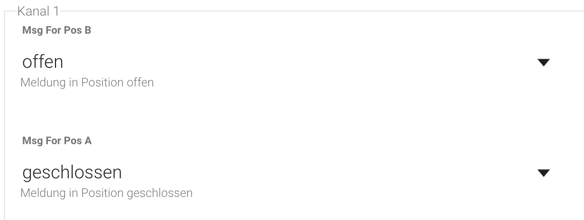

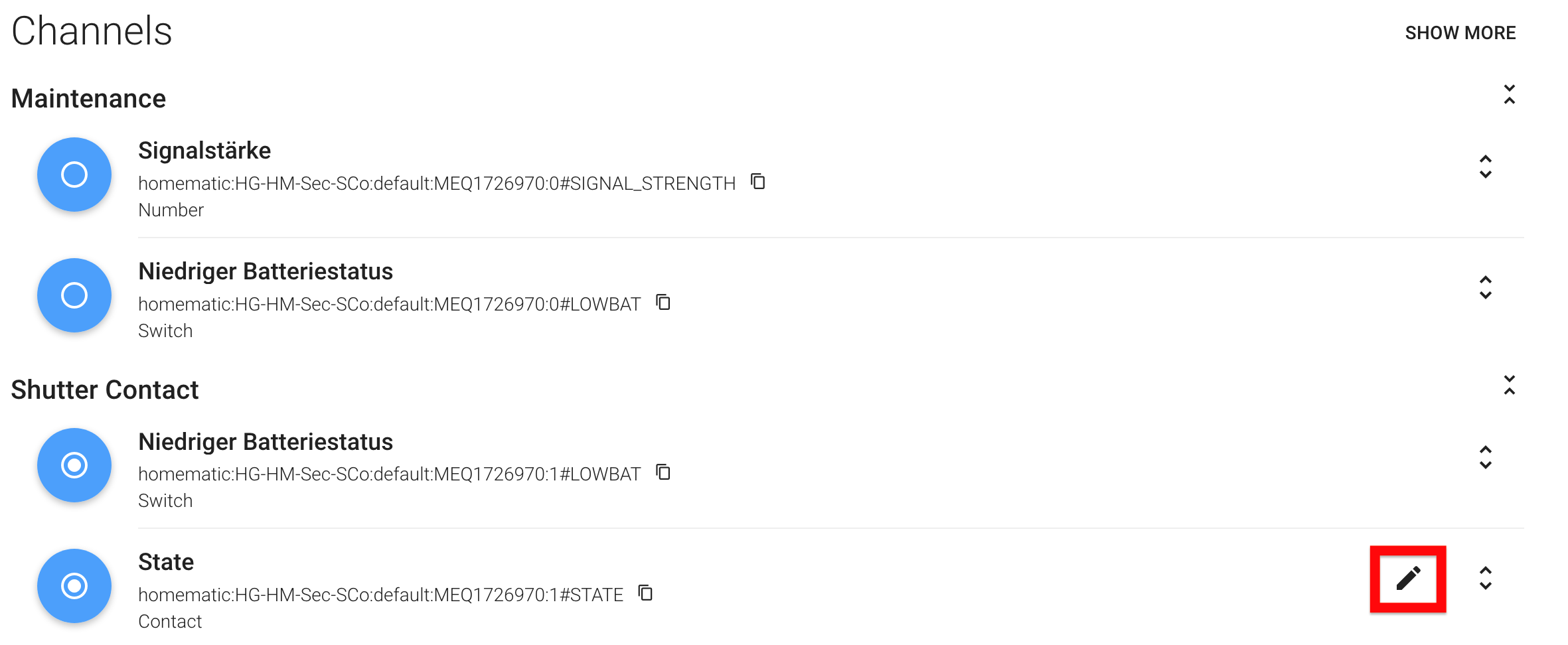

I had a look in the Paper UI.
The windows contacts (3 of 4) don´t have Channels and the thermostats just have some channels (some are even wrong).
One contact is correct, shows two channels and two datapoints per channel.
The other three contacts are only shown with their firmware version and the battery type.
I double checked my Things and Items, the four contacts have the same configuration.

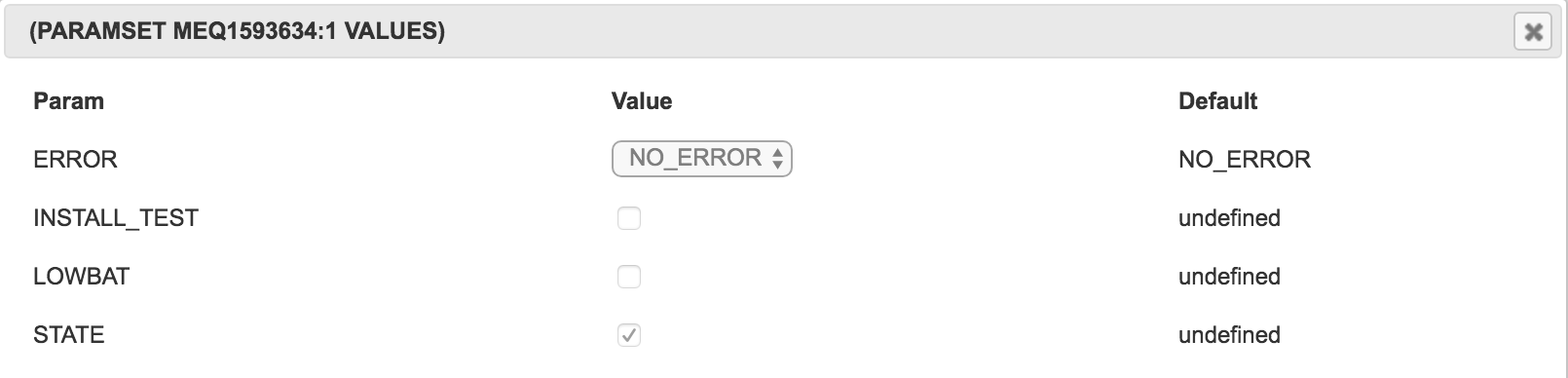

I´ve found something in the jsondb files.
(And a typo in the docs… missing t for jsonlint.com… pull request is already placed)
I´m only able to find the HM_Sec_SC_2 and one of the windows contacts (HM_Sec_SCo).
HG- is used as a prefix everywhere the type is mentioned.
The most interesting part is this:
homematic_HG_HM_Sec_SC_2_default_MEQ1593634_1_STATE
The Type is all uppercase and not lowercase like described in the docs.
I played around with the type and finally found the one that is working:

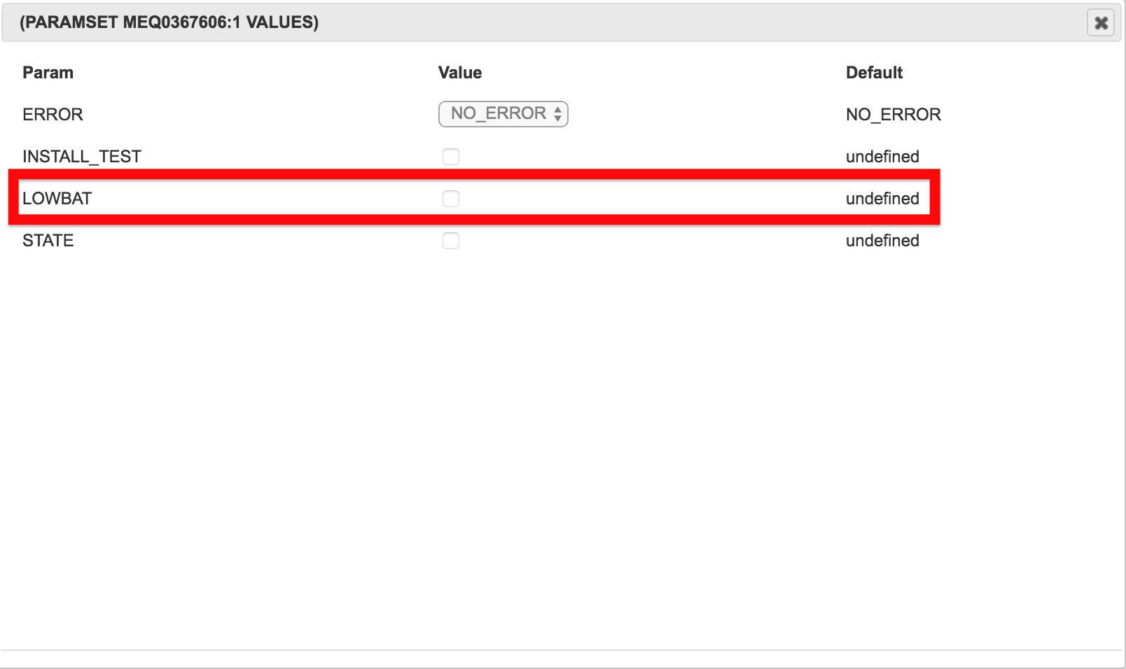

I´m not completely done here.
I don´t get the LOWBAT datapoints working…
While STATE is working fine, i get the same error as before when using LOWBAT.
2018-07-17 20:19:56.991 [ERROR] [.thing.internal.GenericThingProvider] - Channel type homematic:HM-Sec-SC-2_1_LOWBAT could not be resolved.
2018-07-17 20:20:25.010 [ERROR] [.thing.internal.GenericThingProvider] - Channel type homematic:HM-Sec-SC-2_1_lowbat could not be resolved.`
It´s possible to add the following (or first STATE then LOWBAT) and only get the LOWBAT Error.
    Thing HG-HM-Sec-SC-2 SERIALNUMBER "Türschloss" @ "Flur"
        Channels:
            Type HM-Sec-SC-2_1_LOWBAT : 1#LOWBAT
            Type HM-Sec-SC-2_1_STATE : 1#STATE
So it seems like STATE is correct while LOWBAT can´t be used.
But LOWBAT is the correct datapoint!
And even in the jsondb it´s correct…

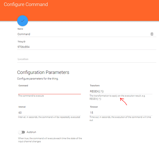

When working with OH 2.x bindings the transformations typically go on the Thing, not the Item. I understand why this is the case but it really makes some use cases pretty awkward. Just look at how hard it is to figure out how to use the Exec 2.x binding.
I would pay good money to extract transformations and make them generic rather than something that the individual bindings have to implement. There are cases where even with bindings like Zwave where it sure would be useful to apply a transformation but we can’t because the binding doesn’t support them. :frowning:
It would also be useful to be able to chain transformation, though I can also see the argument that that more correctly belongs in a Rule anyway.
But it is a huge change and would require lots of buy in from a lot of stakeholders. I’m hesitant to create an issue like this that I have no intention/ability to actually implement.
Does this binding support transformations or were you asking about a different binding?

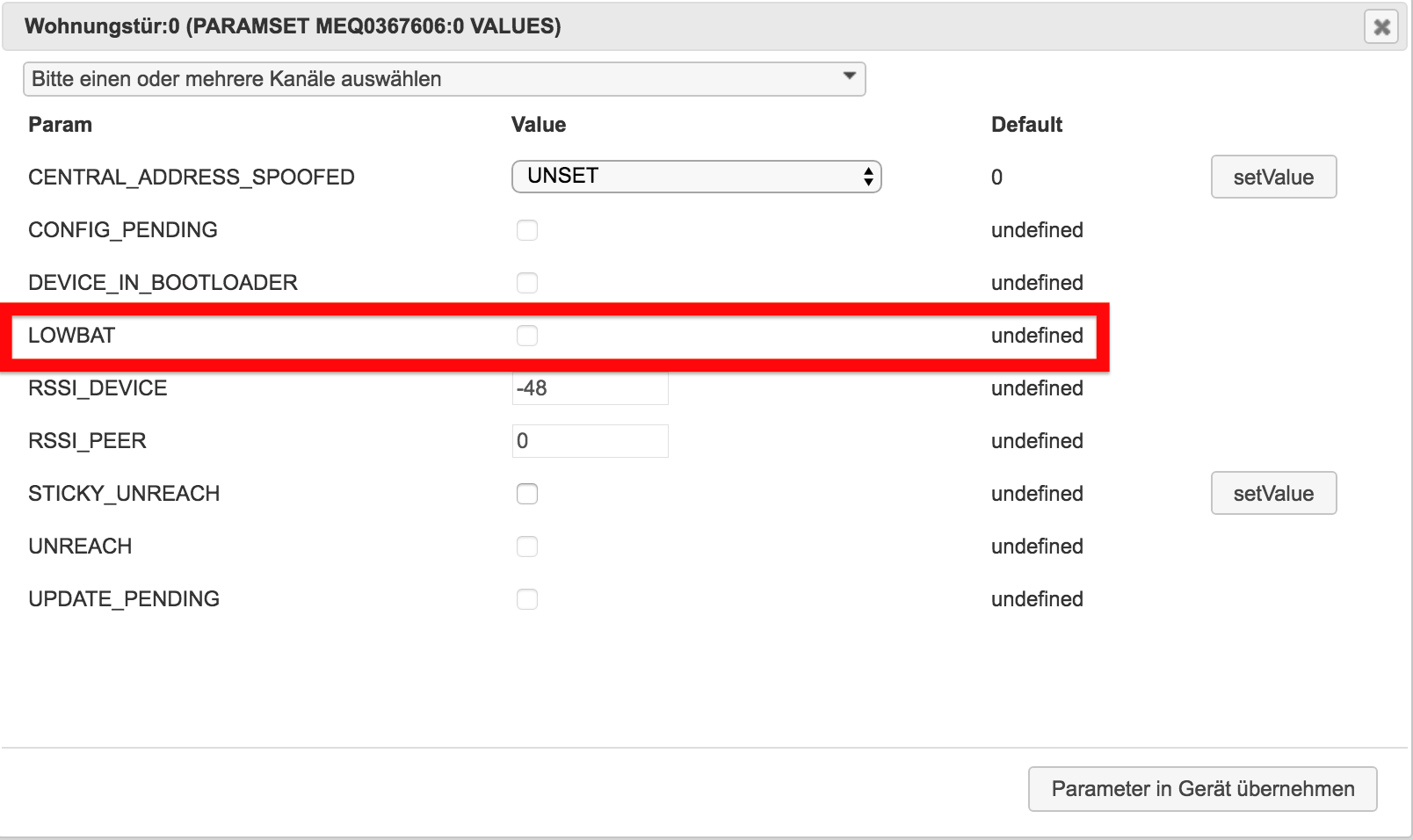

The #LOWBAT datapoint is in the channel 0. (The maintenance channel fi i recall correctly.)

Now i have the Things configured by the Paper UI and the Items still in .items files because i can´t choose an transformation in the Paper UI.
Do you mean this?
The values are shown in german in the Things but not on the Paper UI Control tab or in the Basic UI.
So i don´t know where i could add a transformation when completely working with Paper UI.
Now i only have the Things in the Paper UI and the Items back in .items file.
This way i´m able to at the .map files to the value transformation.
This is possible through the PaperUI Things. But not for all datapoints.
For the windowcontacts it´s only possible for the STATE datapoint.
→ This could be the answer why i´m not able to use LOWBAT as a Thing Type.

LOWBAT is in Channel 0 and 1.
I used the Channel 1 LOWBATin my oH 1.8.3 environment and it worked fine for over three years.

Maybe not. Are you transforming the label? E.g.
String MyItem "My label [MAP(mymapfile.map):%s]
If that is the case, you can enter the stuff between the in the label field for the Item in PaperUI for Items not defined in .items files.
I was thinking of something more along the line of the Exec Binding though:
This is the Thing creation menu where you can define a Transformation on the Thing itself. In OH 1.x and 1.x version binding, this is the same as the transforms that appear between the { } in the Item definition.
