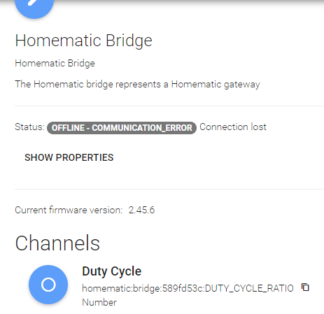

2019-04-19 00:02:38.535 [WARN ] [ommunicator.AbstractHomematicGateway] - Connection lost on gateway 'ccu2', cause: "No Pong received!"
Paper UI sais about my 50 things they are in state OFFLINE - BRIDGE_OFFLINE

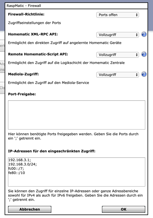

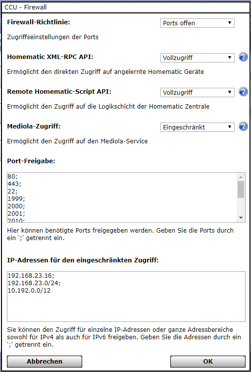

what about these settings:

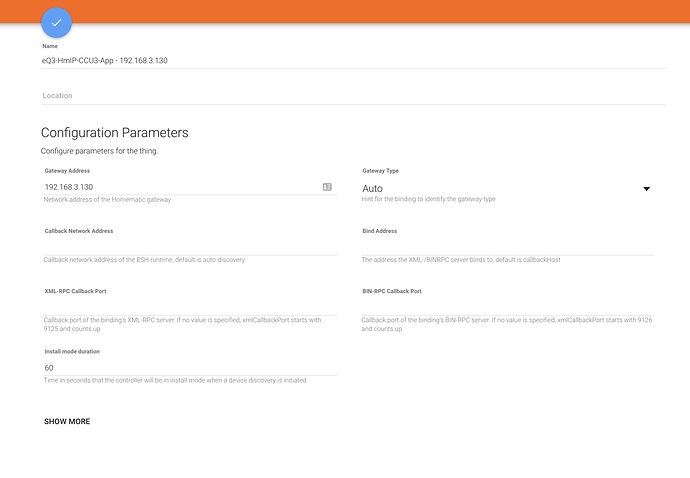

Thanks for your feedback @lukics,
This is how mine looks right now.
Seems like I cannot set the Mediola-Zugriff. As soon as I set it to “full access” the setting reverts to “limited access” on its own.

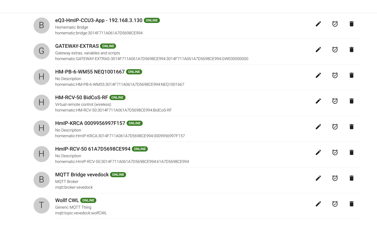

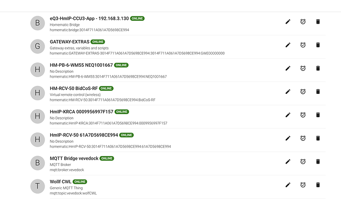

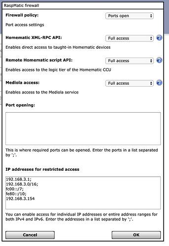

I just ramped up my test system (docker) with M1 milestone build with following configuration:
raspberymatic:
openhab:
HomeMatic stable connected for last 15 minutes.
Thanks @lukics for your efforts to replicate my issue. Appreciate your help on this.
The only difference I can see is that your raspberrymatic replicates a CCU3 and I have a CCU2.

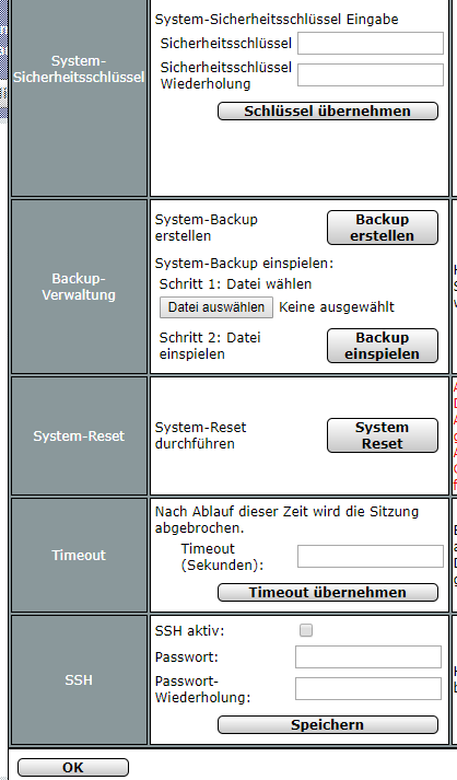

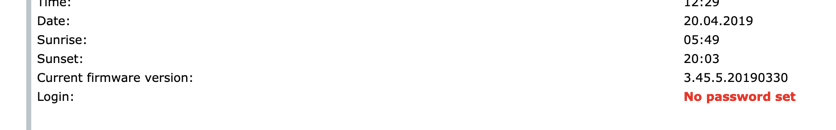

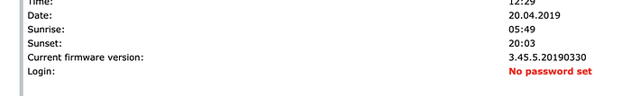

Then I have login password set. Would you mind checking on CCU3 > Controlpanel > Security and check for an “Authentication” check-box. Is that ticked or not?
And last but not least, I’m not able to set “Mediola access” to “full access”. When I try to set it and save, its automatically reverted to “restricted access”
In one of the facebook groups I’m discussing similar topic and some said, that “Authentication” might only be available on CCU3, but not the good old CCU2. So I’m wondering how to configure CCU2 with most recent firmware.

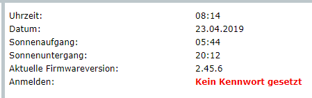

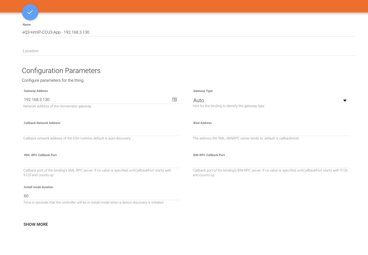

What I did yesterday, was resetting the CCU2 to factory defaults. And I started adding everything from scratch.
After adding the first 3 devices, I added the conection to OH, and still the same behavior as before. SO even on a fresh CCU2 without much tweaks, this issue persists. Here are my most recent CCU2 settings and log from OH2:
Still no “authentication” section

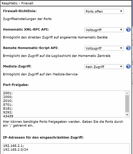

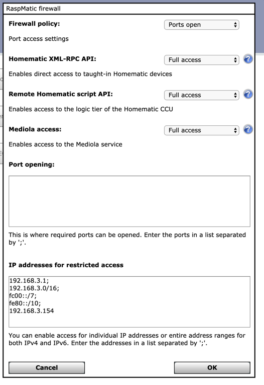

Yes, Raspberrymatic is based on the CCU3 firmware without the Mediola stuff (maybe this causes now the problem).
Here you can see my security settings
In your screenshot I can see that you have added an IP address from a different subnet. Are the CCU and openHAB using different networks? In this case it could be a routing problem.
The additional subnet was a recommendation I found in some HASS documentation. CCU2 and OH2 are on the same subnet.
