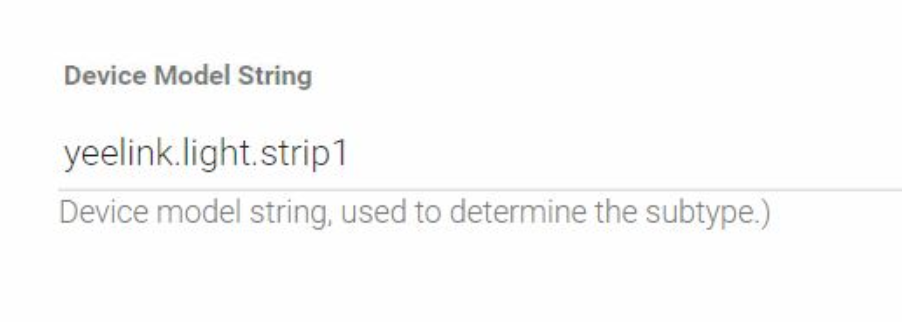

I`m running into Problems when it comes to my Yeelight Stripe (Yeelight YLDD01YL) !
This is what i get from Auto Discovery via the MI IO Binding (yes i got the Token and it`s correct)
String XiaomiMiIOStripe_NetworkSsid "SSID" {channel="miio:basic:04CDB0C8:network#ssid"}
String XiaomiMiIOStripe_NetworkBssid "BSSID" {channel="miio:basic:04CDB0C8:network#bssid"}
Number XiaomiMiIOStripe_NetworkRssi "RSSI" {channel="miio:basic:04CDB0C8:network#rssi"}
Number XiaomiMiIOStripe_NetworkLife "Life" {channel="miio:basic:04CDB0C8:network#life"}
String XiaomiMiIOStripe_ActionsCommands "Execute Command" {channel="miio:basic:04CDB0C8:actions#commands"}
Switch XiaomiMiIOStripe_Power "Power" {channel="miio:basic:04CDB0C8:power"}
Number XiaomiMiIOStripe_Brightness "Brightness" {channel="miio:basic:04CDB0C8:brightness"}
Number XiaomiMiIOStripe_Delayoff "delayoff" {channel="miio:basic:04CDB0C8:delayoff"}
Number XiaomiMiIOStripe_ColorTemperature "Color Temperature" {channel="miio:basic:04CDB0C8:colorTemperature"}
Number XiaomiMiIOStripe_ColorMode "colorMode" {channel="miio:basic:04CDB0C8:colorMode"}
String XiaomiMiIOStripe_Name "Name" {channel="miio:basic:04CDB0C8:name"}
I tried the stable Mi IO Binding and also the latest Snapshot…no Luck.
Doesenmatter what i try - i
m still missing the Color Channel like it comes in my Bulb-Item.
Color XiaomiMiIOBirne_Color "color" {channel="miio:basic:03362ADE:color"}
I also postet a similiar question into Binding Sections…but the i thought maybe I´m such a Noob and it`s a quite easy Problem and not a binding Problem.
Hope someone can provide some useful Information - would love to integrate this Stripe correct.
On/OFF is working - but i`d like to set the colors
