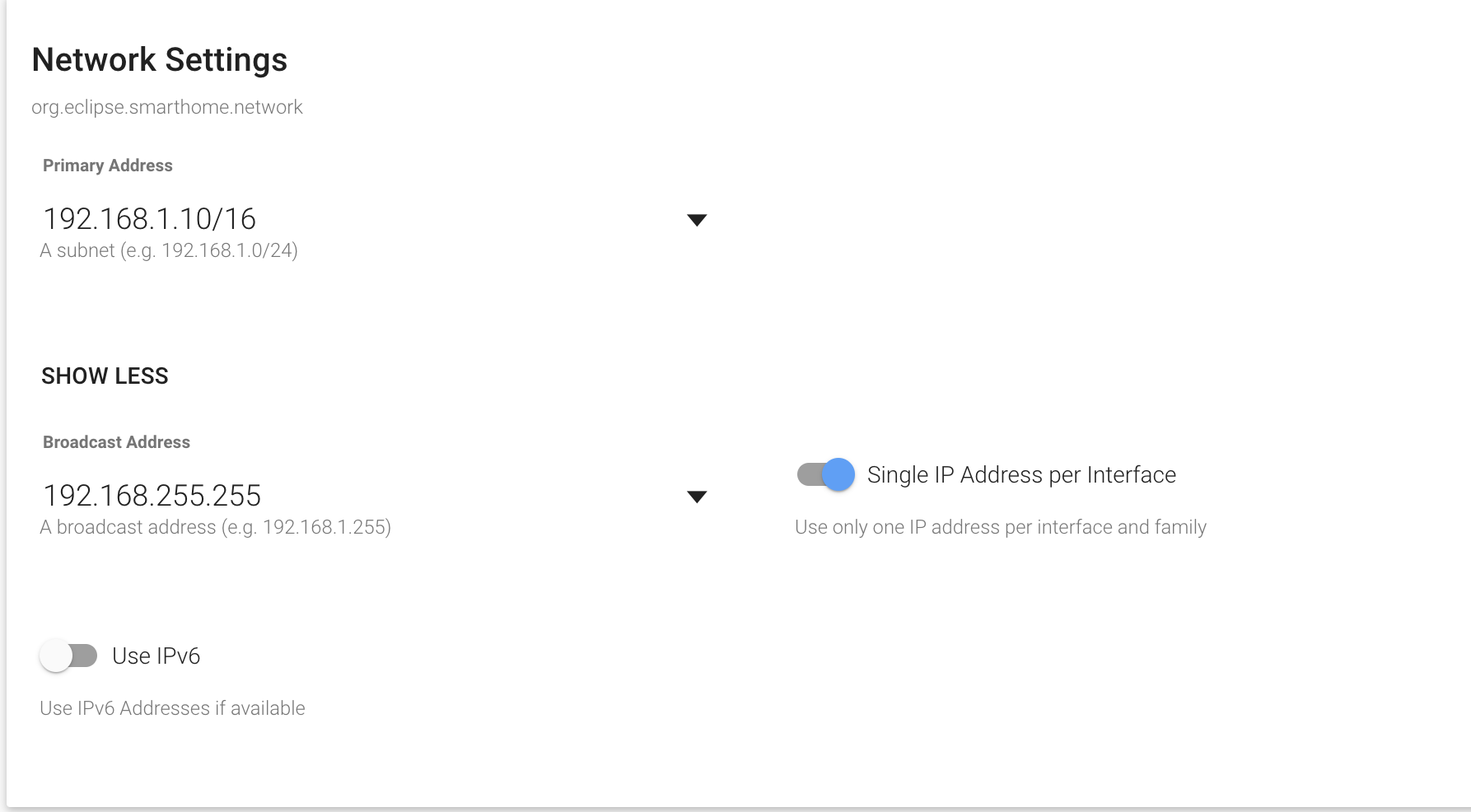

I’d like to override the default network settings:
How can I do it using a config file rather than setting it via paperui?

Not correct Bruce,
it is simply some entries in conf/runtime.cfg
org.eclipse.smarthome.network:broadcastAddress=192.168.255.255
org.eclipse.smarthome.network:primaryAddress=192.168.1.10/16
org.eclipse.smarthome.network:useIPv6=false
org.eclipse.smarthome.network:useOnlyOneAddress=true
