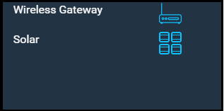

Here is a screenshot
Any ideas on how to move the text ‘Wireless Gateway’ down so that it aligns with the bottom of the icon? This is probably a noob question, but I am just starting to learn :slight_smile:

And an updated screenshot
