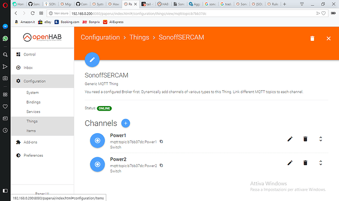

The problem could be anywhere in the communication between your sonoff and openhab.
  1. What info does your sonoff publish and to which mqtt topics?
  2. In what format does it publish the info?
  3. Is your topic channel on openhab configured correctly to receive the info?
  4. Do you need to transform the info to make openhab understand it?
Maybe the problem is on the channel.

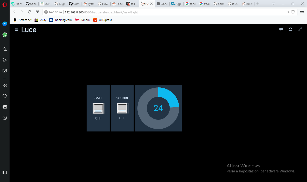

I set the Dimmer “DimmerCam” but the field of the state and command in openhab are blank.
This because i want to use the dimner only to determine the time that the rule wait for turn off the switch.
I’m not expect e response from the sonoff
I think this is correct.
Don’t you think that?

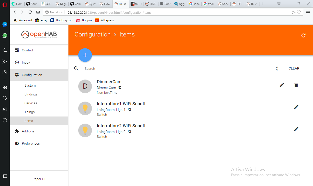

If i erase the variable x and i put a number as argument of the command TIMER it works correctly
So, this is just a value to be used for timing?
Why have you made it a Dimmer Item, a Number would be more sensible surely.
If you only want to use the value in a rule why have linked it to MQTT?
That’s right. So i should unlink from the Mqtt broker.
This evening i will try and i hope to resolve.
I continue to use the dimmer only to set a % of opening of the blind
I report the situation:
Now It doesn’t work.
i unlink the dimmer from mqtt.
the DimmerCam is now defined as a number that i use in the rule:
