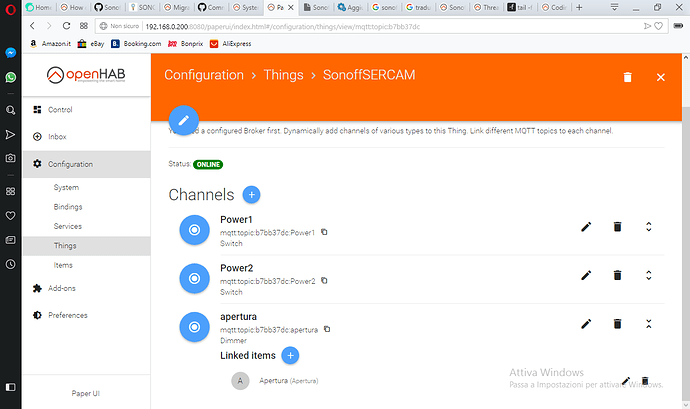

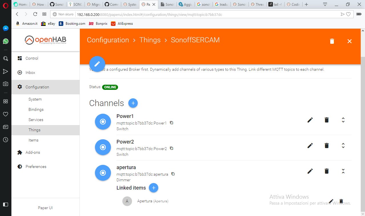

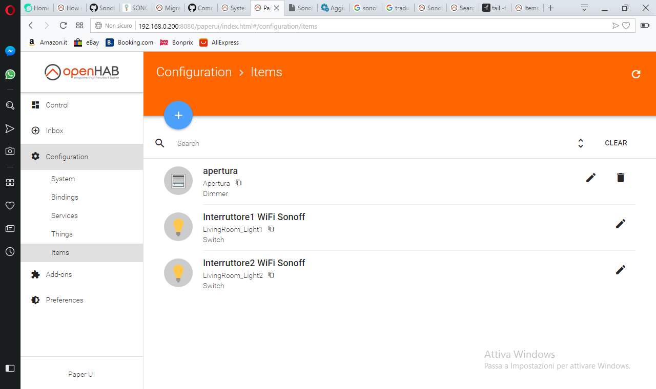

That’s because the item name is Apertura, not apertura as I noticed in the screenshots you showed.
