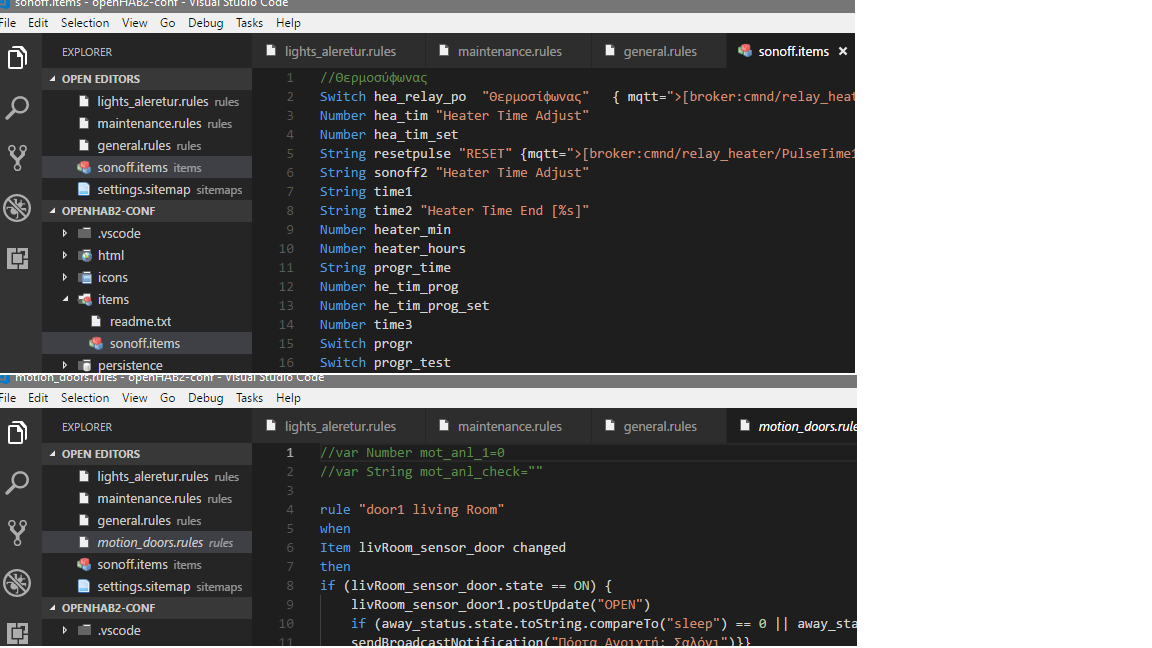

I will say something stupid but i noticed that the colors of the words are different in some pictures on internet.
