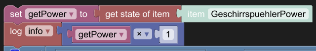

I have been struggling with the conversion to a number also. Your suggestion to use a multiply times one does the trick perfectly. Thanks for that :smiley:

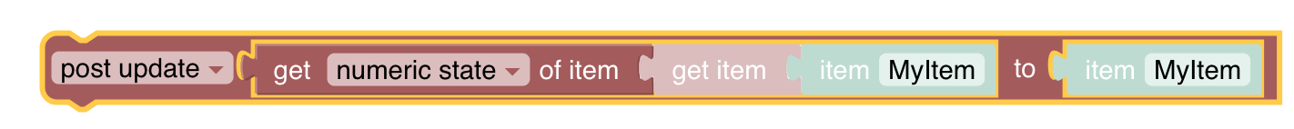

For OH 4+ users:
  1. make your “virtual item” be just a Number and the units will be stripped off for you when you post update from the rule
  2. Or if you don’t want units in the first place, make the shellyem…Power_Consumption_1 Item be just a Number Item and the units will be dropped in the first place.
This doesn’t help with OH 3.4 but I wanted to make it clear for current and future OH 4 users that this is supported and much easier.
I believe 2 and 3 above will work in OH 3.4 too.

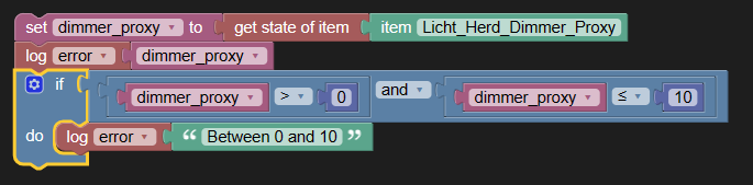

Just faced the same problem (thanks for the thread) when building a logic to convert dimmer values into dimmer values the LEDs can actually handle (flickering-problem).
I’m on OH 4.1, and both paths seem to work:
Going via the variable-path:
Going via the new UoM-route (requires OH 4):
Even though the latter is probably cleaner (is it?) I’ll go for the variable-path, since it looks way nicer in Blockly.

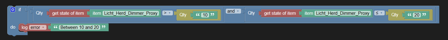

Update on what brought me here: Doing this…
… worked for a couple of checks (between 0 and 20, 20 and 40, and so on, but surprisingly not for the area between 80 and 100). Comparing numbers to strings appears to be not the most stable thing to do. :wink:
There is no reason to use the Qty blocks unless at least one of the operands is a Quantity. If you are working with Dimmers, you are working with a PercentType, not a Number:Dimensionless so neither operand has units and the Qty blocks are superflous.
But I do see a problem with this version. “get state of item” returns the state of the Item as a String, always, no matter what type the Item is. If you want to compare the Item’s state to a number, use the `“get [name] of item” block and change the “name” to “numeric state”.
I worry that as written you might be doing a String comparison instead of a numerical comparison.
That settles that my concerns are founded, though the weird behavior is not expected.

Surprisingly what I had at the beginning (comparing with Strings) did not work with the „80-100 behavior“. What I described above (working with variables) works great. So unless there’s another quick fix that’s neater, I‘d probably leave things as they are.
