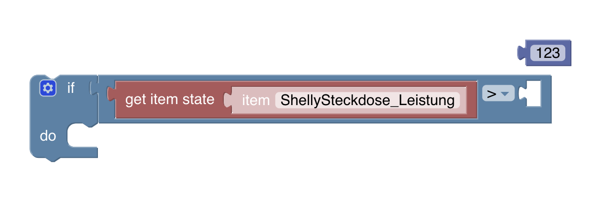

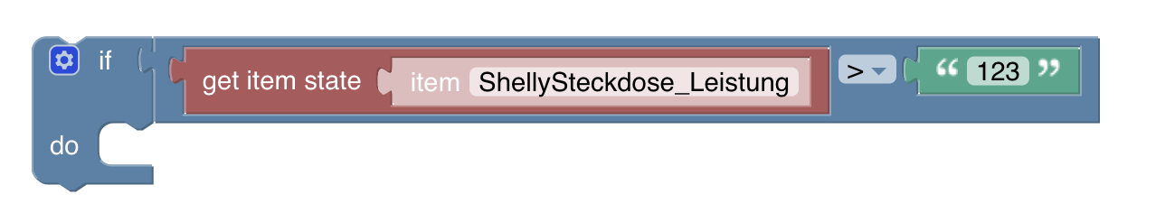

I am trying to write a rule in Blockly where I retrieve the energy of a plug thing which I want to compare against a number
even though the item is defined as follows which should be a number
blockly only allows me to compare it to a string which to me feels wrong, doesn’t it?

Actually, that’s not a plain old number. That;s a QuantityType that carries a Unit of Measurement (UoM). So it’s not just 123, it’s 124 kWh.
I suspect that Blockly does not know anything about UoM yet so this type of comparison may not be possible.
Even if the Item were a Number, it might not be able to handle the Number. I don’t know that. Blockly is still very basic and needs lots of work to become wholly viable.

However, even if I change the item to become Number only the comparison still doesn’t work in Blockly. It seams it wants to compare to Strings only which still feels weird to me and kinda unclean. Maybe it will do some casting in the background then? I’ll try that out in a moment and come back if it works. I first wanted to write the rule in DSL, so I know if it works in general and now I try to replicate it with blocky.

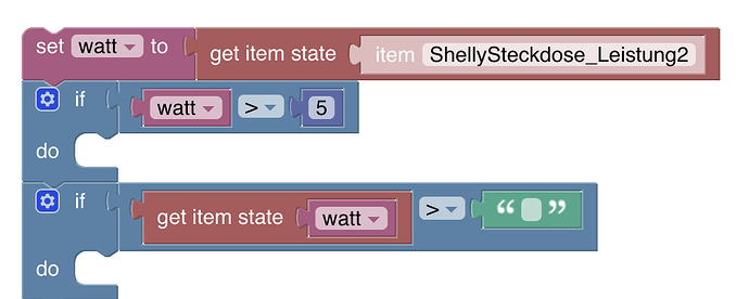

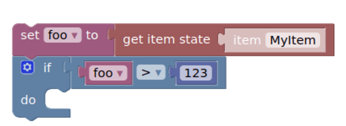

As I indicated, Blockly is really basic right now. I would not be surprised if comparing Numbers like that is simply not yet supported. I’ve not played with Blockly enough yet to find all of it’s limitations. But I just clicked around in it and if you assign the Item state to a variable it will let you compare the variable to a Number from the Math set of blocks.

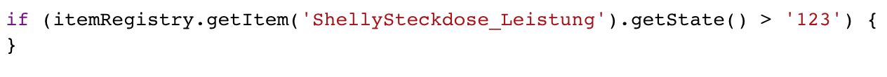

The code generated is:
var foo;
foo = itemRegistry.getItem('MyItem').getState();
if (foo > 123) {
I think that may work.
Yep, pretty clever idea of you!
Here is the comparison:
results into:
watt = itemRegistry.getItem(‘ShellySteckdose_Leistung2’).getState();
if (watt > 5) {
if (itemRegistry.getItem(watt).getState() > ‘’) {
solved - thanks, Rich!
Stefan
You might file an issue on the openhab-uis repo on this. Functionally there is no difference between assigning it to a variable first and comparing it to the state directly so I would call this a bug.

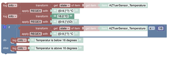

You can strip of the UoM for example by applying a regex like in the following example and then compare the value.
see Blockly Transformations
Or you can always use an Blockly inline script to manipulate data directly with ECMA Script:

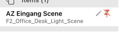

I am not sure if you know the developer sidebar?
It is actually used to pin items to access them easily. I could image that the current state of that item could be also displayed here like a watch window in a debug but you had to ask @ysc here.
Also another option for you could be to use the “event monitor” in the sidebar that can show you all events, that come in which is a lot. However, can filter them with that little icon:
In this case I added the following filter: “openhab/items/F2_Office_Desk_Light_Scene” (you can add multiple in a comma separated way):
This is added to the side of the blockly rule and maybe that could help you.

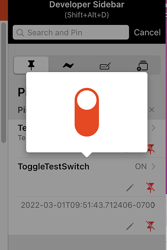

If you pin an Item you will see its current state and even be able to interact with it (e.g. toggle the switch). You can also navigate to the Item’s configuration page where you can change it if needed. It should be updated and show the state even as it changes on the server side.
The event filter is another way, as you demonstrate, and it’s the best way to see when an Item received an update to the same state. But in all other cases, it’s easier to just pin the Item.
Interesting and thanks for mentioning it. I am surprised that I didn’t see this above in my example:
Once you are done pinning, you need to hit “cancel”. It’s a bit counter intuitive I know. You can go back and pin more or remove them but until you hit “cancel” you are kind of in “edit mode”. Once you hit “cancel” you’re in use mode and you’ll see the current states and control widgets.
I’ll think about it a bit but it’s probably worth changing that “cancel” to “done”.
