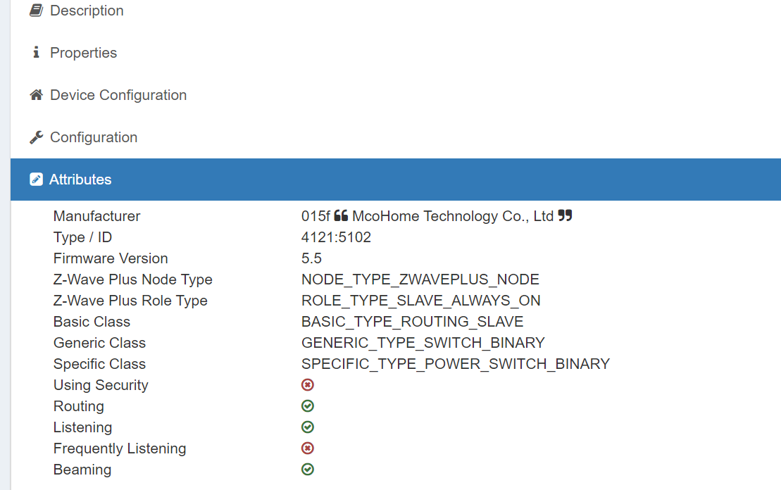

There are actually 2 different database entries for this switch, with differing device identification. It would be helpful to know which you have. I find it easiest to use HABmin and go to
Configuration → Things → [your switch]. In the right pane, all the way at the bottom, expand Attributes . The Manufacturer & Type/Id are what we are interested in. Here i an example from a different device. Do not worry if it shows "unknown Manufacturer. That just means OpenHABian does not know.
Ok managed to see the information you @Bruce_Osborne mentioned but don’t understand how this information helps to add it to the DB.
I wanted to know which of our entries was your switch.

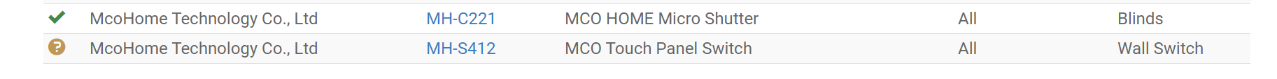

Your particular device is not in our database. We have 4102:0202 and an incomplete 0412:0000

The last entry on the DB is the one i added.

Done:
https://www.cd-jackson.com/index.php/zwave/zwave-device-database/zwave-device-list/devicesummary/1142
Please verify all parameters as I just copied them from your old device.
