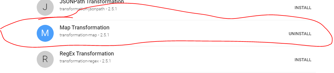

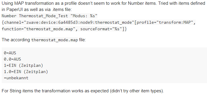

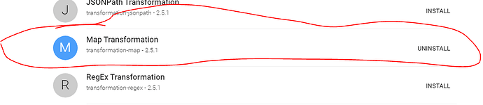

I followed your solution for doing kind of the same in my case, but it does not work.
I hope you can help me.
Situation: From my smart meter, I get tariff info in number format (0001 or 0002)
I would love to replace the numbers by text: 0001 should be ‘Day’ and 0002 should be ‘Night’.
I have, as you mentioned, put the mapping in the item label:
Number Elektriciteit_TariffIndicator “Huidig Tarief: [MAP(tariff.map):%s]” { channel=“dsmr:electricity_emucs_v1_0:1:emeter_tariff_indicator” }
Is your Item now a Number or a String type? Look in your events.log to see what states it is taking up.
When it is a Number, it won’t be 0001, it’ll be just 1 when converted to a string for lookup in the MAP. You can have both 1= and 0001= in your map file.
