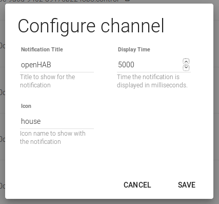

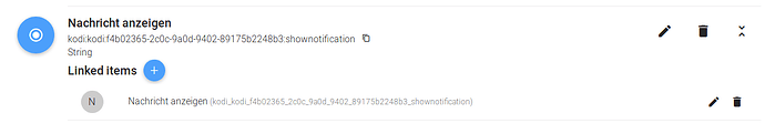

Yes, it is. According to the docs the shownorification channel type has three configuration parameters. Note: the icon parameter accepts one of the openHAB icons (as listed here).
What is your preferred way of configuration? This is a short how-to in Paper UI:
  1. Click on “Show more” button
  2. Link an item to the Channel
  1. Click on the top “Edit” button (pencil)
  1. Change the configuration for your needs.
But I am afraid there is no dynamic way to change the configuration during runtime. If you need different types of notification you rather have different kinds of notifications that you want to process and with the current solution you can nicely define one channel for each notification type. IIRC this in only possible in textual configuration.

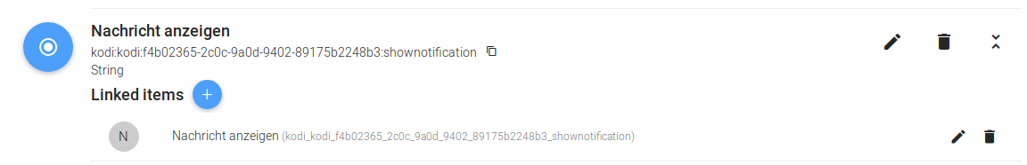

Tried to add a notification channel and then another one. I do not see the channels in Paper UI, but the channels are there in the jsondb things file. Restarting and clearing the cache did not work. Any idea? Also about deleting these channels again?
/EDIT: “Show more” did it. Did not notice it before. Sorry…
