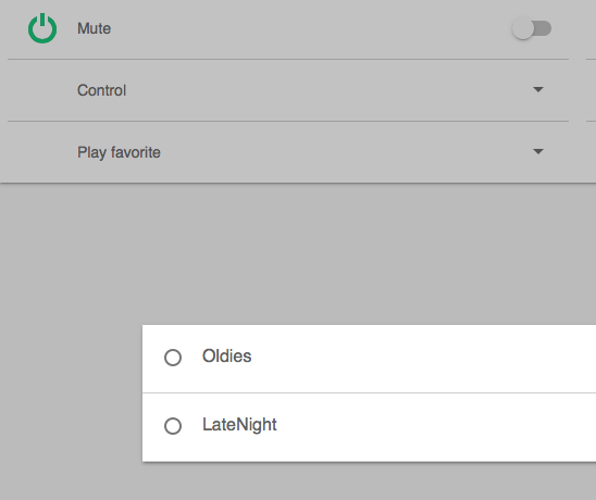

Here the screenshot of play favorite as it appears in the PaperUI control section, which I am unable to replicate in my .sitemap file.
paperuikodi

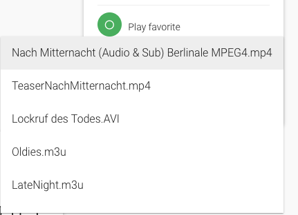

Vincent, thanks again. Unfortunately the Java escape sequence is not accepted, but taken as syntax error. (See screen-shot) - Sitemap stops showing when trying it.

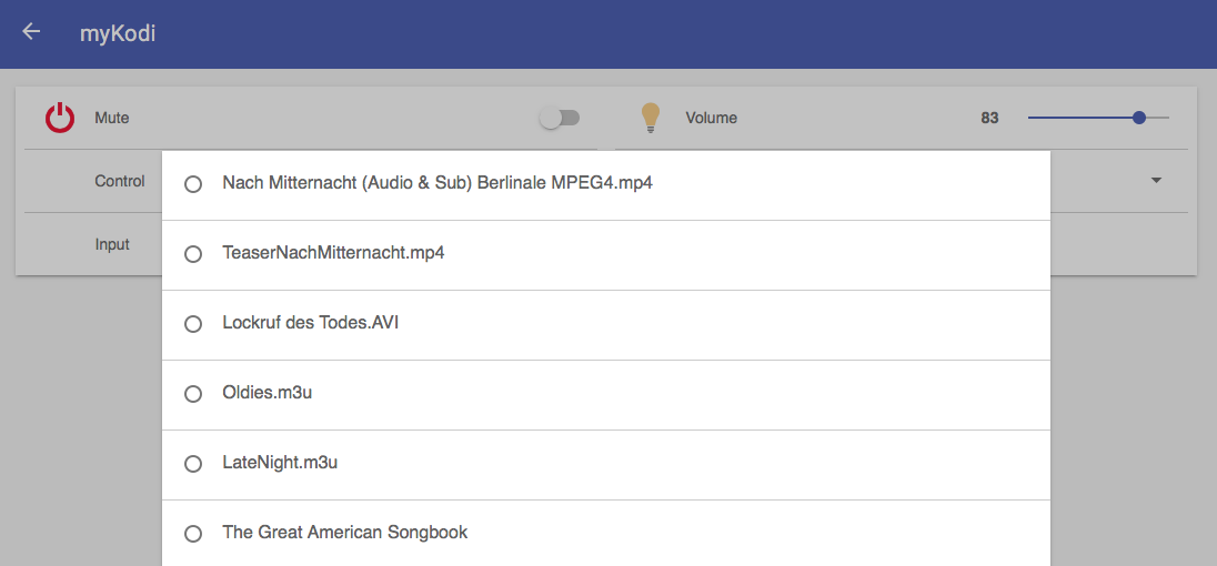

Here the screenshot:
KodiFavourites
