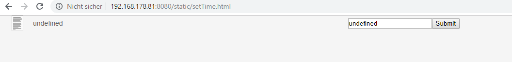

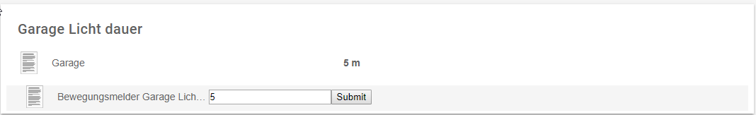

i have a problem with the Milestone build, i have a html file added to the gui, but the view is broken, it was working with 2.3, now i am on 2.4 M6 and this is my first milestone build i have installed.
in 2.3 it looks like:
this is the code of the html file:
<html class="ui-icons-enabled">
<script>
var openHabianPI = "192.168.178.81"
function getParam(param)
var qs = (function(a) {
if (a == "") return {};
var b = {};
for (var i = 0; i < a.length; ++i) {
var p=a[i].split('=', 2);
if (p.length == 1)
b[p[0]] = "";
else
b[p[0]] = decodeURIComponent(p[1].replace(/\+/g, " "));
return b;
})(window.location.search.substr(1).split('&'));
return qs[param]
function httpGet(theUrl)
var xmlHttp = new XMLHttpRequest();
xmlHttp.onreadystatechange = function() {
if (this.readyState == 4 && this.status == 200) {
document.getElementById('textInput').value = xmlHttp.responseText;
xmlHttp.open("GET", theUrl, true);
xmlHttp.setRequestHeader("Accept", "text/plain");
xmlHttp.send();
return
function httpPut(theUrl, theValue)
xmlHttp.open("POST", theUrl, true);
xmlHttp.setRequestHeader("Content-type", "text/plain");
xmlHttp.setRequestHeader("Accept", "application/json");
xmlHttp.send(theValue)
function sendValue()
url = "http://" + openHabianPI + ":8080/rest/items/" + getParam('item');
httpPut(url, document.getElementById('textInput').value)
function getValue()
url = "http://" + openHabianPI + ":8080/rest/items/" + getParam('item') + "/state";
httpGet(url)
</script>
<head>
<link rel="stylesheet" type="text/css" href="../basicui/mdl/material.min.css" />
<link rel="stylesheet" type="text/css" href="../basicui/material-icons.css" />
<link rel="stylesheet" type="text/css" href="../basicui/roboto.css" />
<link rel="stylesheet" type="text/css" href="../basicui/smarthome.css" />
<script src="../basicui/mdl/material.min.js"></script>
<style>
form {
margin-bottom: 0;
.mdl-form__row {
border-bottom-style: none;
height: auto;
padding-top: 0;
padding-right: 0;
padding-bottom: 0;
padding-left: 0;
</style>
</head>
<body class="mdl-color-text--grey-700" data-icon-type="svg">
<form action="JavaScript:sendValue()">
<div class="mdl-form__row mdl-cell mdl-cell--6-col mdl-cell--8-col-tablet">
<span class="mdl-form__icon">
<img data-icon="text" src="../icon/text?format=svg" />
</span>
<div class="mdl-form__label" id=label>
</div>
<div>
<input type="text" name="textInput" id="textInput">
</div>
<div>
<input type="submit" value="Submit">
</div>
</div>
<script>
document.getElementById('label').innerHTML = getParam('label');
document.getElementById('textInput').value = getValue()
</script>
</form>
</body>
</html>
