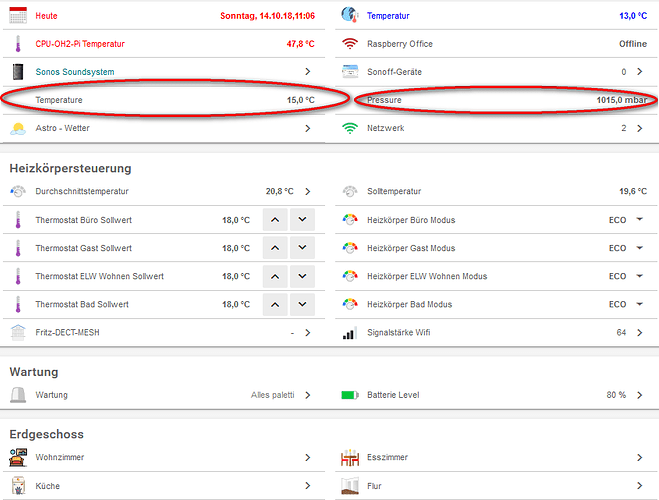

I have http-binding installed to get data from a website, to extract several values.
- Installed HTTP-binding via Paper-UI.
2.Activated http.cfg

- Created two items
String Test_1 "Test1" {http="<[owm_test:450000:JSONPATH($.[1].weather.main.temp)]"}
Number Test_2 "Test2" {http="<[owm_test:450000:JSONPATH($.[1].weather.main.pessure)]"}
- Tested my Url via Browser and got this

The Logger shows me now:
2018-10-14 01:27:10.173 [INFO ] [smarthome.model.script.weather-rules] - Forecast executed
2018-10-14 01:29:07.686 [WARN ] [ab.binding.http.internal.HttpBinding] - Transformation 'JSONPATH($.[1].weather.main.temp)' threw an exception. [response={"coord":{"lon":9.xx,"lat":48.yy},"weather":[{"id":800,"main":"Clear","description":"Klarer Himmel","icon":"01n"}],"base":"stations","main":{"temp":12.73,"pressure":1017,"humidity":87,"temp_min":11,"temp_max":14},"visibility":10000,"wind":{"speed":2.1,"deg":270},"clouds":{"all":0},"dt":1539471000,"sys":{"type":1,"id":4891,"message":0.0054,"country":"DE","sunrise":1539409142,"sunset":1539448393},"id":1234567,"name":"Berlin","cod":200}]
org.openhab.core.transform.TransformationException: Invalid path '$.[1].weather.main.temp' in '{"coord":{"lon":9.87,"lat":48.89},"weather":[{"id":800,"main":"Clear","description":"Klarer Himmel","icon":"01n"}],"base":"stations","main":{"temp":12.73,"pressure":1017,"humidity":87,"temp_min":11,"temp_max":14},"visibility":10000,"wind":{"speed":2.1,"deg":270},"clouds":{"all":0},"dt":1539471000,"sys":{"type":1,"id":4891,"message":0.0054,"country":"DE","sunrise":1539409142,"sunset":1539448393},"id":1234567,"name":"Berlin","cod":200}'
at org.openhab.core.transform.TransformationHelper$TransformationServiceDelegate.transform(TransformationHelper.java:67) ~[193:org.openhab.core.compat1x:2.4.0.M4]
at org.openhab.binding.http.internal.HttpBinding.execute(HttpBinding.java:194) [221:org.openhab.binding.http:1.13.0.M4]
at org.openhab.core.binding.AbstractActiveBinding$BindingActiveService.execute(AbstractActiveBinding.java:144) [193:org.openhab.core.compat1x:2.4.0.M4]
at org.openhab.core.service.AbstractActiveService$RefreshThread.run(AbstractActiveService.java:166) [193:org.openhab.core.compat1x:2.4.0.M4]
2018-10-14 01:29:07.696 [WARN ] [ab.binding.http.internal.HttpBinding] - Transformation 'JSONPATH($.[1].weather.main.pessure)' threw an exception. [response={"coord":{"lon":9.xx,"lat":48yy},"weather":[{"id":800,"main":"Clear","description":"Klarer Himmel","icon":"01n"}],"base":"stations","main":{"temp":12.73,"pressure":1017,"humidity":87,"temp_min":11,"temp_max":14},"visibility":10000,"wind":{"speed":2.1,"deg":270},"clouds":{"all":0},"dt":1539471000,"sys":{"type":1,"id":4891,"message":0.0054,"country":"DE","sunrise":1539409142,"sunset":1539448393},"id":1234567,"name":"Berlin","cod":200}]
org.openhab.core.transform.TransformationException: Invalid path '$.[1].weather.main.pessure' in '{"coord":{"lon":9.87,"lat":48.89},"weather":[{"id":800,"main":"Clear","description":"Klarer Himmel","icon":"01n"}],"base":"stations","main":{"temp":12.73,"pressure":1017,"humidity":87,"temp_min":11,"temp_max":14},"visibility":10000,"wind":{"speed":2.1,"deg":270},"clouds":{"all":0},"dt":1539471000,"sys":{"type":1,"id":4891,"message":0.0054,"country":"DE","sunrise":1539409142,"sunset":1539448393},"id":1234567,"name":"Berlin","cod":200}'
2018-10-14 01:36:38.571 [WARN ] [ab.binding.http.internal.HttpBinding] - Transformation 'JSONPATH($.[1].weather.main.temp)' threw an exception. [response={"coord":{"lon":9.xx,"lat":48.xx},"weather":[{"id":800,"main":"Clear","description":"Klarer Himmel","icon":"01n"}],"base":"stations","main":{"temp":12.5,"pressure":1017,"humidity":81,"temp_min":11,"temp_max":14},"visibility":10000,"wind":{"speed":0.5},"clouds":{"all":0},"dt":1539472800,"sys":{"type":1,"id":4891,"message":0.0033,"country":"DE","su
Have i forgotten something to set?
Is there someone to help me ?
Thank’s in advance
