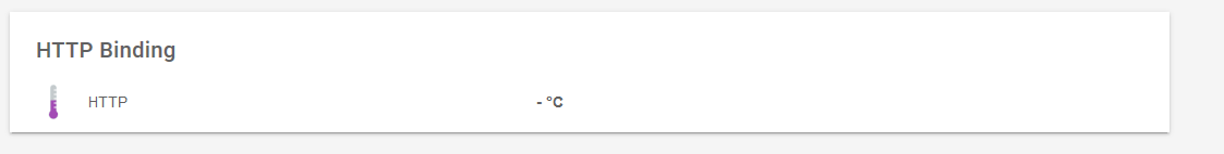

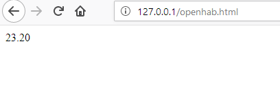

I tried it and after some tries i found that if i remove the HTTP:// and replace the HTTP from the begin to HTTP1 with lowercase i dont get any error but still the value in the sitemap does not update!
Number HTTPstring "HTTP [%.2f °C]" { **http**="<[http://192.168.2.20/openhab.html:1000:REGEX((.*?))" }
Without error
Number HTTPstring "HTTP [%.2f °C]" { http1="<[192.168.2.20/openhab.html:1000:REGEX((.*?))" }
