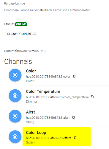

Did write a few scenes for myself - maybe you can use a bit of that:
Items:

    { channel="hue:0210:ecb5fa004e07:stripe2:color" }
Dimmer Hue_LR_Showcase_Left_Brightness
    "Hue Vitrine links Helligkeit [%d %%]"
    <light>
    (Hue_LR_Showcase_Left)

Switch Hue_LR_Showcase_Left_Effect
    "Hue Vitrine links Effekt"
    <party>
   	{ channel="hue:0210:ecb5fa004e07:stripe2:effect" }

Alterntively you could simply switch on the effect-channel:
Not exactly random but looping through all the colours.
Hi @job thanks for the reply I know about the color loop channel its not quite what I was after im saving that for other things :wink:
