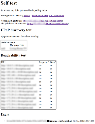

I am having an issue with my Logitech Harmony Hub not able to pair with the Hue Emulation service. It used to work up until the end of June when I moved my Docker container on to a different host. Since then it is not longer working. I am currently running the latest OH 2.5 snapshot build 1665 docker image.

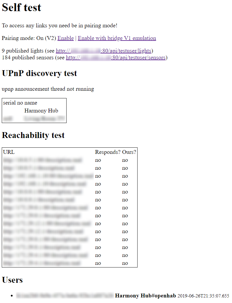

Looking at the self status page, none of the URLs are marked as responsive while I can access through my browser along with any of the URLs from the server where OH is running. I am using nginx to proxy into my OH server. Also, the binding seems to be able to pick devices broadcasting on my network including my Harmony Hub.
After increasing the debugging logs, I don’t see any self test failure or any other errors that would explain the reason for my issue. So I assume the self tests aren’t failing but they somehow end up being considered as unresponsive. The fact that the self test page is showing the upnp announcement thread not running is probably the resulting issue here. Just to be sure, I tried to remove the hue configuration from my Harmony Hub setup but wasn’t able to pair against after that.

Self test api status

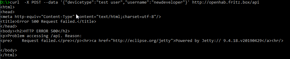

When I try to connect via the command line with cURL, when device pairing is off, there is no difference:
vs.
However, whe device pairing is on, there is a difference:
vs.
However, I dont’t get the point: The Hue Emulation is the server side. So why can’t you just ignore, whether or not the client sends the accept header?
As a last resort, you could make it configurable in the settings?
I did some testing, and I didn’t see issues with the Accept header. For me it appears Jetty returns 415 if a client sends “content-type” header on any GET request.
I made a filter that removed this header, and then all started working again. There might be a better way to instruct Jetty to ignore superfluous Content-Type headers.

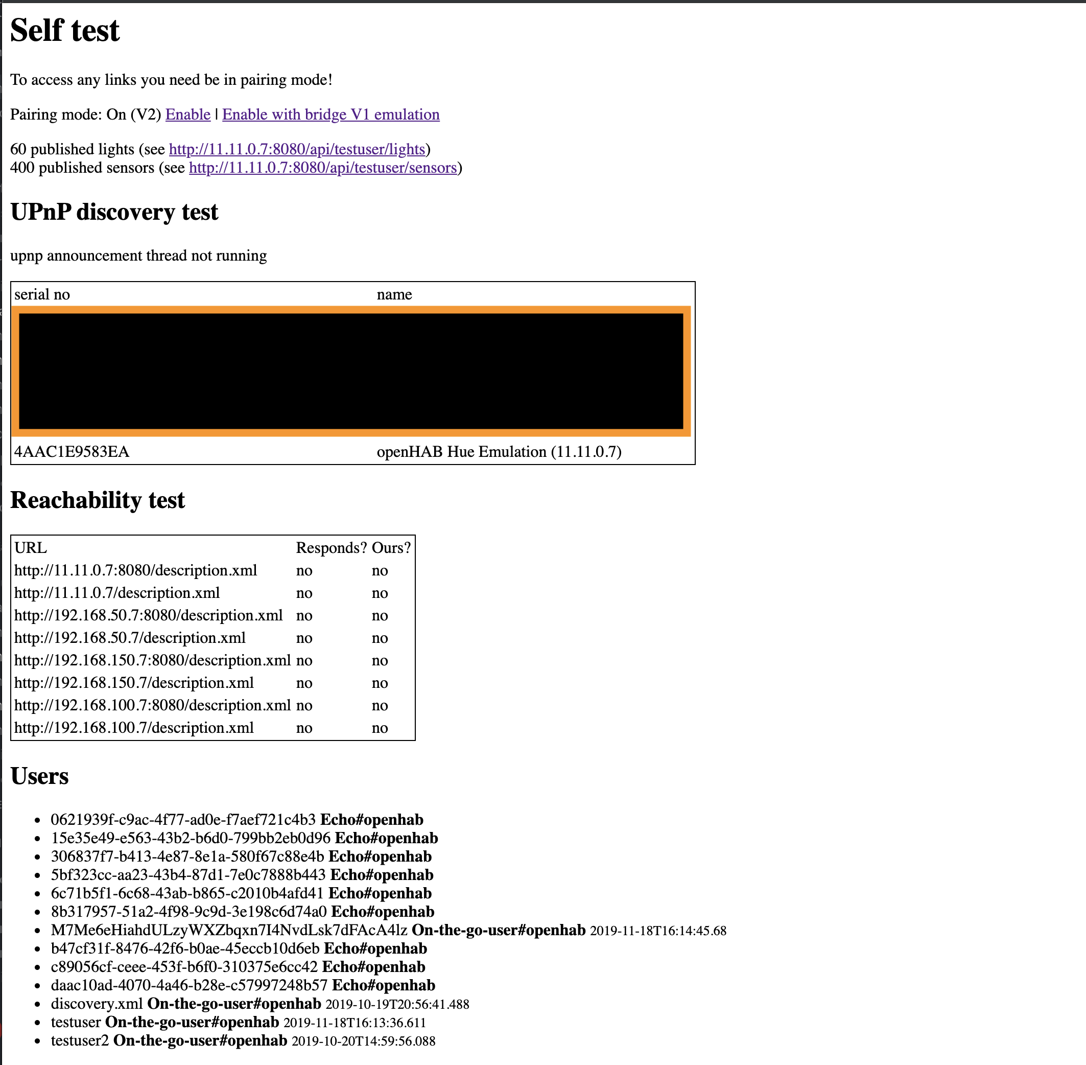

I have merged the last patch of @ngrodum. I think hue emulation is in good shape again for the OH 2.5 release. What bugs me is that the status report page does not seem to work as expected if I look at the posted screenshot from above.
The reachability tests failed and the page says “upnp announcement thread not running” while it is clearly working as seen in the table.
