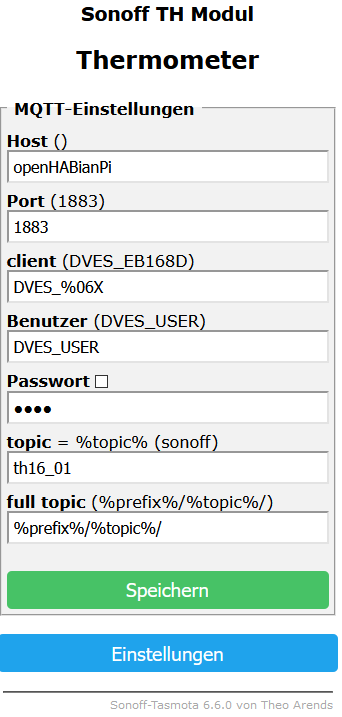

and a screenshot of my MQTT-Setup of the TH16
Hope this can help you for your additional tests.
