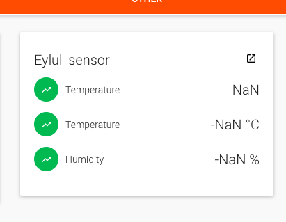

I am trying add Sonoff Th with am2301. And I added but It is’not seen right;
Ads%C4%B1z
I haven’t done anything other than adding channels in Paper ui.
Where am I wrong? What do I not do now?

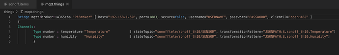

First you have to create at least one mqtt generic thing (or use homie or homeAssistant compliant devices - afaik tasmota does provide homie standard).
Channels are created as part of the Thing (or are autodiscovered when using homie or homeAssistant).

As you see in the example files from @H102 you do need a bridge (the broker thing you have created on PaperUI, hopefully with correct settings) AND you need a generic MQTT thing (representing your actual sonoff device) which connects to this bridge. Using files this connection is done by the above used syntax, on PaperUI you need to select the already created broker thing.
On this generic MQTT thing you need to create the channels ( switch and two numbers).
Having done that via file you would need to restart openHAB or at least the mqtt bundle ( that is a known bug of 2.4 which is already solved in more recent versions).

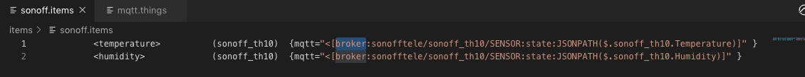

I’ve actually made all the suggestions. There was a problem like the screenshot I added in my first message.

In your Items;
... { mqtt="<[ ...
is the syntax for MQTT binding version 1.
This will never work with MQTT binding version 2, which works with Things and channels.
You had channel links configured before, don’t know why you changed that.
