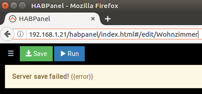

I have the similar problem. In the “view” mode I see only a black browser screen. In the “edit” mode I get this:
On my RPI I see the data from the config. Also in the paper UI. Everything looks ok. I guess, that the client can not access to this configuration of my RPI.
Please give me a hint, where I will find the cause of this problem.
Bernhard
Your problem is not similar to the OP (he didn’t have HABPanel at all)
You have access to HABPanel but something else is wrong
What do you mean? I don’t think that I got it :slight_smile:
Did you create your HABPanel configuration with all your settings?
Most likely your nginx configs are fooked (I see that you are accessing the URL without 8080)
#3, #9
Sorry.
I am still a beginner. Therefore I used this area “beginners” of this community.
Thank you for the tip to look in the direction of nginx. I use the habPanel with the same client I made the configuration. And it es real nice. My wife wants me to use our old Windows RT device. But there - and on other clients - I get this boring message …“Server save failed {{error}}”.
Believe me, I tried a lot … and I could not find a solution in this board.
