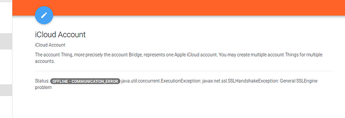

i have picked up a problem with the icloud binding. after i updated both myne and the boss ( the wife) iphones to ios 13.it just stoped functioning. nothing gets updated. i checked the logs. and don’t really see anything.
here is a screen grab from paperui:

Which version of openHAB do you use? Theres a fix for this issue available (from snapshot build #1656 or 2.5.0.M2 milestone release onward), see iCloud SSL issue again - #37 by wborn

So you will have to upgrade, or follow the steps shown in the linked thread to manually upgrade the certificate.
i use openhabian. so i will upgrade in any case. and give feedback once done.
what would you segest to install ?
and how would i do that with the openhabian-config ?
so i upgraded to the latest snapshot. and changed my things file back to how i had it and now everything is back and working. thank you all for the speedy help. :handshake: :clap: :vulcan_salute:
