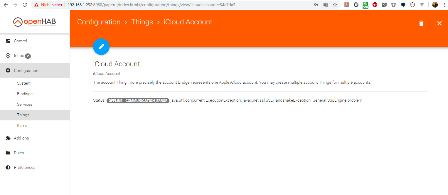

Good evening,

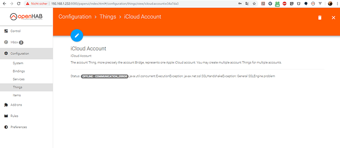

openHAB gives me a general SSL engine error when adding the iCloud Thing. Is anyone already fixing this bug?
I haven’t found an issue on GitHub yet.
Would be cool if this could be fixed :wink:
Information:
openHAB 2.4 Release Build
iCloud Binding 2.4.0
Kind regards,
Mark

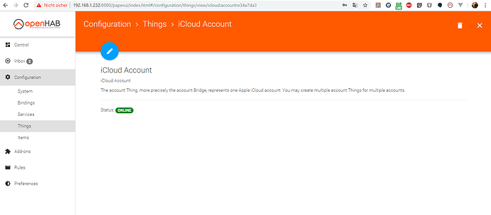

I made the Update and my iCloud Account is now online
but unfortunately I don’t get it yet to put my IOS device online.

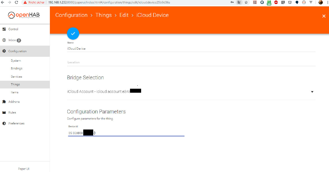

It is not recognized automatically. Therefore I entered the IMEI number by hand. (see screenshot)

Also, where did you get that the deviceId is the IMEI?
As the docs says:
A device is identified by the device ID provided by Apple
Has nothing to do with the IMEI. I just looked up my iCloud devices and its deviceId’s are a much longer and ID with numerical and alphanumerical characters in it
ok cool.
Where can i find this specific ID? the binding does not find my mobile automatically…

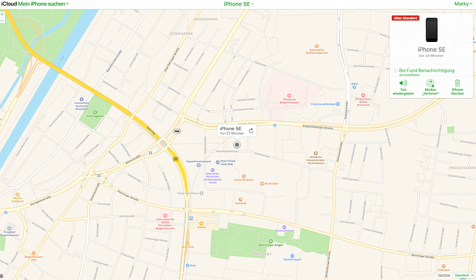

My browser can also find my phone via the iCloud Web UI.

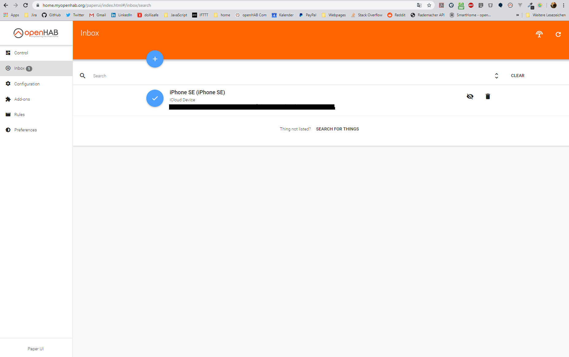

Did you tried pressing the “+” sign on the Inbox and select the iCloud binding and force the auto-discovery again?

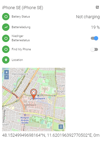

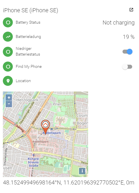

days later…my phone is now in the inbox… :slight_smile:
and all items work too :slight_smile:
Thank you for your help guys @rkrisi @rlkoshak :slight_smile:
