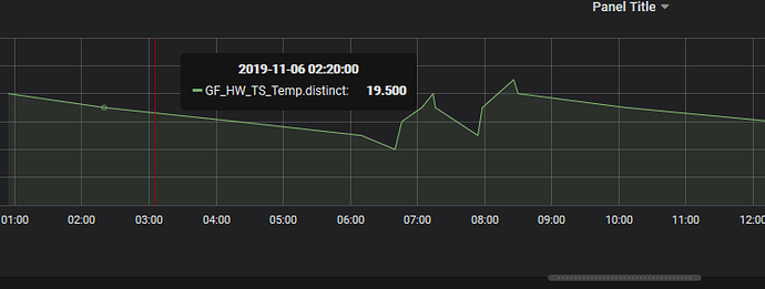

After lots of fiddling I think I’ve got my influx / grafana services working. However, I’m now not sure if / what it is persisting as I can’t seem to recall any data from it.
