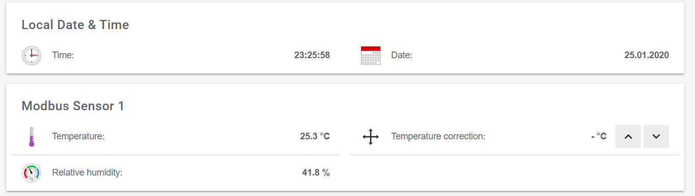

I would like to initialize value of an item to 0 when de system restarts but it does not work. The item I want to initialize is used as a setpoint item in my sitemap. Its purpose is to adjust the temperature reading of a Modbus RTU sensor later on. When the system restarts i would like it to be set to an offset of 0°C or even better to remember the value from before the restart.

  1. Added it to the sitemap(HVAC.sitemap):
sitemap HVAC label="HVAC Monitoring"
           Frame label="Modbus Sensor 1" {
        Default     item= Temperature_read  icon="temperature"      label="Temperature: [%.1f °C]"
        Setpoint    item= Temp_correct      icon="movecontrol"      label="Temperature correction: [%.1f °C]"    minValue=-10 maxValue=10 step=0.5
        Default     item= Humidity_read     icon="humidity"

  1. I get this error:

Have a look here
Thank you, both of you!!! That solved my problem and pointed to me to a part that i should read once more. I have read so much of the documentation the last days that it is getting a bit blurry in my head.
Even better:
This is the better syntax for postUpdate
Explanation there: Textual Rules | openHAB
rule "Startup"
    System started
    Temp_correct.postUpdate(0)
It’s a lot at first but soon the concepts will seem second nature. Just ask question when you get stuck
I’ve read and understood it. Will change that first thing after i got some sleep. Thank you!
