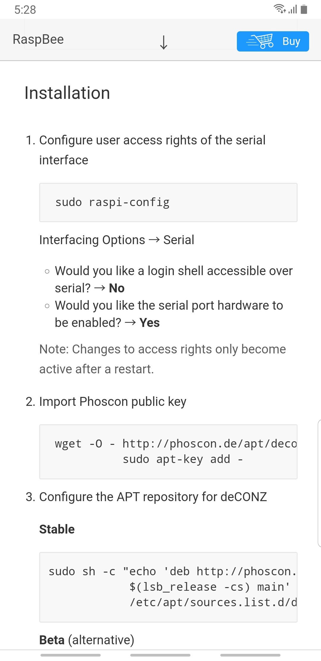

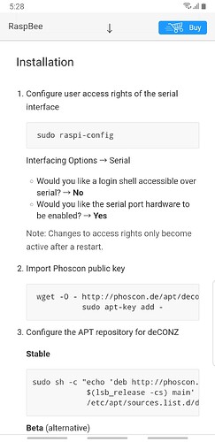

deConz requires enabling Serial Port through Interfacing Options in the rasp-config. I used Openhabianpi, hence, no raspi-config.
How can I enable the port?
I have searched, but couldn’t find answer.
I flashed the latest image then upgraded to the 2.5.0M2
I think it is solved (hardware is recognized) by adding
enable_uart=1
at the end of
/boot/config.txt
Reference:
https://spellfoundry.com/2016/05/29/configuring-gpio-serial-port-raspbian-jessie-including-pi-3/#Enabling
