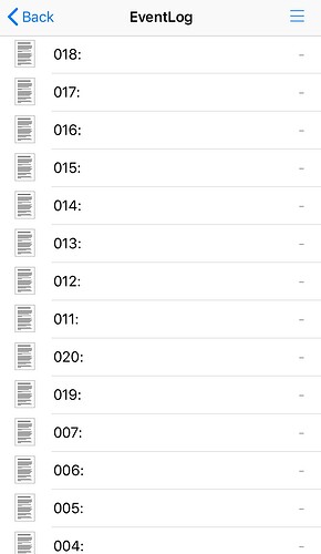

thats strange.. there are no other options to see history data?
here an example with current issue:
Group gEventLog "EventLog" (All)
String EventLog00   "001: [%s]" (gEventLog)
String EventLog01   "002: [%s]" (gEventLog)
String EventLog02   "003: [%s]" (gEventLog)
String EventLog03   "004: [%s]" (gEventLog)
String EventLog04   "005: [%s]" (gEventLog)
String EventLog05   "006: [%s]" (gEventLog)
String EventLog06   "007: [%s]" (gEventLog)
String EventLog07   "008: [%s]" (gEventLog)
String EventLog08   "009: [%s]" (gEventLog)
String EventLog09   "010: [%s]" (gEventLog)
String EventLog10   "011: [%s]" (gEventLog)
String EventLog11   "012: [%s]" (gEventLog)
String EventLog12   "013: [%s]" (gEventLog)
String EventLog13   "014: [%s]" (gEventLog)
String EventLog14   "015: [%s]" (gEventLog)
String EventLog15   "016: [%s]" (gEventLog)
String EventLog16   "017: [%s]" (gEventLog)
String EventLog17   "018: [%s]" (gEventLog)
String EventLog18   "019: [%s]" (gEventLog)
String EventLog19   "020: [%s]" (gEventLog)
Group gEventInternal "Event Vars" (All)
result:
your code goes here
