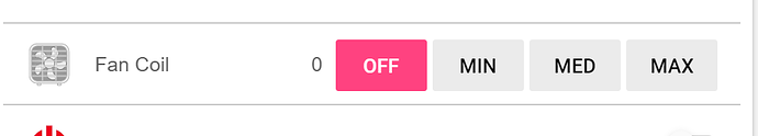

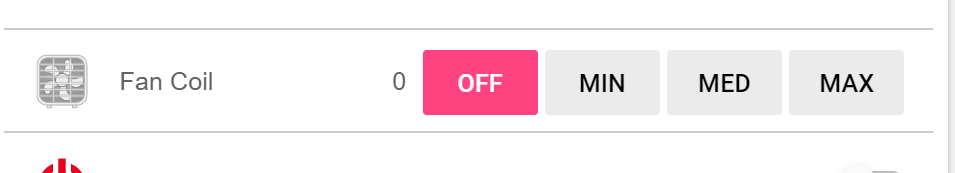

Hi, So I was trouble shooting the same issue on 2.4 where I had a dummy item with the fan mode that should be updated and next rule would take it’s state and set relays accordingly. It was a nightmare until I found this thread, thank you. Relying on the receivedCommand and posting a self update does the trick but it takes .3 second to get that state updated and can sometimes confuse a rule if someone is trigger happy with setting setpoints up and down with the arrows like maniac.
Anyone is already on the 2.5? has the issue been fixed
With no idea what “issue” you are talking about, it would be difficult to say.
Just about every hurdle encountered in this thread is actually openHAB working as designed, but not understood by the user.
Let me clarify.
So if I have a dummy unconnected switch ..
What is a logic that I can’t simply update it from another rule by sending postUpdate to it?
I need to sendCommand and then in the rule that is based on receivedCommand i need to self update it ?
Also why is that in that script if I do self update, and read state in the next line imediately it most likely will not be updated yet, the state will still hold the old state.
rule "{{actor_fc}} fancoil update"
  Item {{actor_fc}}_fancoil_mode received command
  val recieved_fc_mode = receivedCommand
  postUpdate ({{actor_fc}}_fancoil_mode,recieved_fc_mode)
  var Number fancoil_mode = {{actor_fc}}_fancoil_mode.state
to work around i need to add some if statements to compare them and check recieved_fc_mode and state are the same.
And I just spent another hour on that I see that sometimes if the dummy switch receives the command it state updates on it’s own, me not touching postUpdate. And sometimes it does not.
