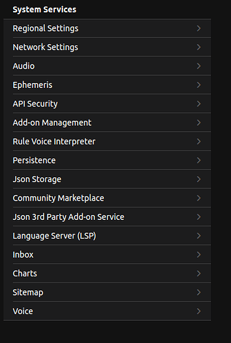

crazy thing is… in the old version I know under Settings → Other Services → JRuby Scripting there was Jruby now look???
I’m I blind???
Um, no, you’re not blind. Mine doesn’t show it either?! I can still go directly to /settings/services/org.openhab.automation.jrubyscripting though.

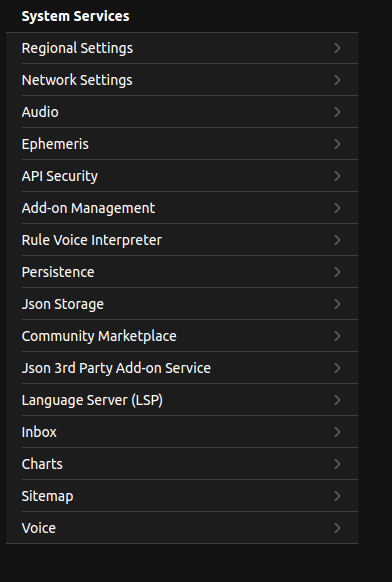

We are currently working on redesigning the settings page of Main UI, in the mean time, the addon settings can only be accessed though the blue gear icon from the addon page in the addon store.

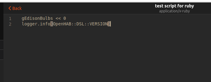

And if I do a script of this:
logger.info(OpenHAB::DSL::VERSION)
I get this in the log:
2023-08-15 08:13:43.399 [INFO ] [hab.automation.jrubyscripting.script] - 5.5.0

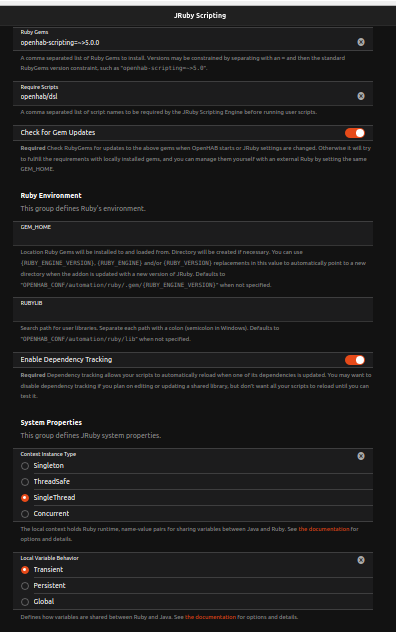

@florian-h05 Hmm, but that sends me to /settings/addons/automation-jrubyscripting/config, which just allows setting some log level (I’m not sure for which logger), not to /settings/services/org.openhab.automation.jrubyscripting.
EDIT: Holy crap Cody

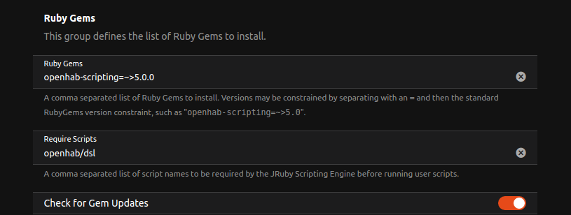

I noticed you had
openhab-scripting=~>5.0
and I had
openhab-scripting=~>5.0.0
I changed it to match yours and error gone!!!

what am I doing wrong?
I don’t know if this will be readable but here is my config
An upper case first letter is a constant in Ruby, so goes through const_missing instead of method_missing in the library, and those two hooks have slightly different semantics. I feel like I remember fixing a bug like this in some cases, but I can’t find a commit for it between 5.0.1 and now.
I kinda thought that might have something to do with it after reading the variables documentation. From the error messages I also suspected I had the wrong library loaded. I really appreciate your help.

The add-on config page allows to set the log level for the addon package logger (org.openhab.automation.jrubyscripting).
I have created https://github.com/openhab/openhab-addons/pull/15438 to make the service settings appear in the addon settings.
