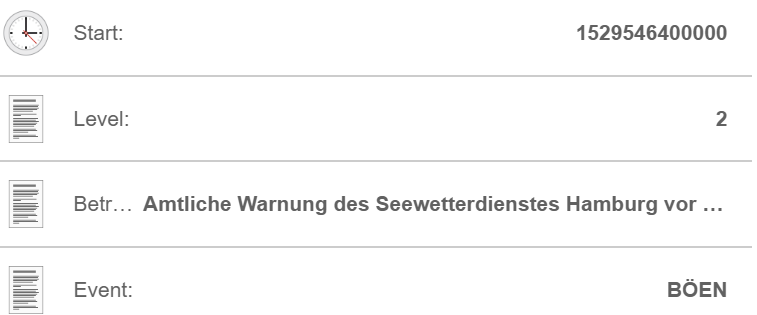

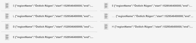

Hi there,
any ideas why it looks like the following? I guess something is wrong in my rules, but I’m not able to identify that.
My items:
String		DWD_Unwetter_start					"Start: [%s]"
String		DWD_Unwetter_end					"Ende: [%s]"
String		DWD_Unwetter_level					"Level: [%s]"
String		DWD_Unwetter_description			"Beschreibung: [%s]"
String		DWD_Unwetter_headline				"Betreff: [%s]"
String		DWD_Unwetter_instruction			"Hinweis: [%s]"
String		DWD_Unwetter_event					"Event: [%s]"
my rules
rule "Unwetterwarnung DWD"
   Time cron "0 * * ? * *"
	var String jsonString = sendHttpGetRequest("https://www.dwd.de/DWD/warnungen/warnapp/json/warnings.json")
	jsonString = transform("JS", "getDWDjson.js", jsonString)
	DWD_Unwetter_start.postUpdate(transform("JSONPATH","$start",jsonString))
	DWD_Unwetter_end.postUpdate(transform("JSONPATH","$end",jsonString))
	DWD_Unwetter_level.postUpdate(transform("JSONPATH","$level",jsonString))
	DWD_Unwetter_description.postUpdate(transform("JSONPATH","$description",jsonString))
	DWD_Unwetter_headline.postUpdate(transform("JSONPATH","$headline",jsonString))
	DWD_Unwetter_instruction.postUpdate(transform("JSONPATH","$instruction",jsonString))
	DWD_Unwetter_event.postUpdate(transform("JSONPATH","$event",jsonString))
	DWD_Unwetter_last_update.postUpdate(new DateTimeType())
my transformation:
(function(jsonString) {
var newString = jsonString.replace('warnWetter.loadWarnings(','');
newString = newString.replace(');','');
var newJSON = JSON.parse(newString);
var jsonResult = "";
if (newJSON.warnings.hasOwnProperty('501000008')) {
    jsonResult =JSON.stringify(newJSON.warnings['501000008'][0]);
} else jsonResult = 'NULL'
return jsonResult;
})(input)
and my sitemap:
Text item=DWD_Unwetter_start
Text item=DWD_Unwetter_end
Text item=DWD_Unwetter_level
Text item=DWD_Unwetter_description
Text item=DWD_Unwetter_headline
Text item=DWD_Unwetter_instruction
Text item=DWD_Unwetter_event
Many thanks!
Matthias

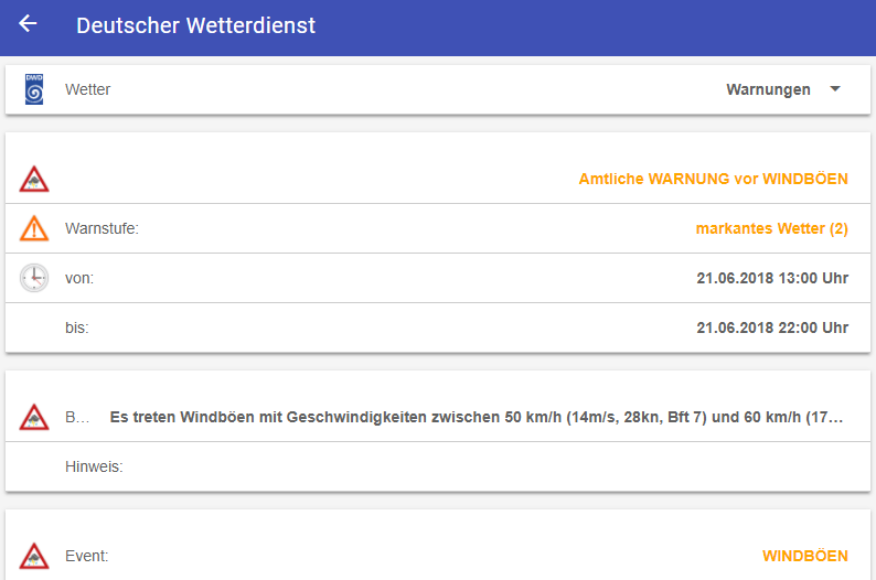

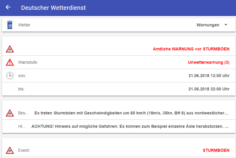

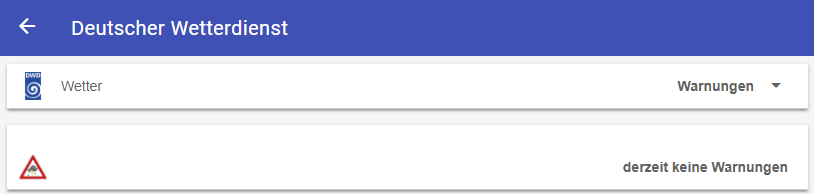

NOW here is my final config:
first of all you need the following Add-ons:
/items/DWD_Warnungen.items
DateTime	DWD_Warnung_start			"von: [%1$td.%1$tm.%1$tY %1$tH:%1$tM Uhr]"	<time>
DateTime	DWD_Warnung_end				"bis: [%1$td.%1$tm.%1$tY %1$tH:%1$tM Uhr]"	<time>
Number		DWD_Warnung_level			"Warnstufe: [MAP(DWD_Warnung.map):%s]"		<dwdwarnung>
String		DWD_Warnung_description			"Beschreibung: [%s]"				<warnung>
String		DWD_Warnung_headline			"Betreff: [%s]"					<warnung>
String		DWD_Warnung_instruction			"Hinweis: [%s]"					<warnung>
String		DWD_Warnung_event			"Event: [%s]"					<warnung>
/transform/DWD_Warnung.map
0=Keine Warnung (0)
1=Wetterwarnung (1)
2=markantes Wetter (2)
3=Unwetterwarnung (3)
4=extremes Unwetter (4)
10=Hitzewarnung (10)
/transform/get_DWD_warnings_json.js
DO NOT FORGET replace WARNCELLID with your WARNCELLID
http://www.dwd.de/DE/leistungen/gds/help/warnungen/cap_warncellids_csv.csv?__blob=publicationFile&v=4
if (newJSON.warnings.hasOwnProperty('WARNCELLID')) {
	jsonResult =JSON.stringify(newJSON.warnings['WARNCELLID'][0]);
return jsonResult;
})(input)
/rules/Update_DWD_Warnungen.rules
rule "DWD Warnungen"
	Time cron "0 */5 * ? * *"  //every 5 Minutes
//	Time cron "0 * * ? * *"    //every 1 Minute
	var String newString = transform("JS", "get_DWD_warnings_json.js", jsonString)
	if (newString !="NULL") {
		var String newStart = transform("JSONPATH", "$.start", newString)
		var DateTime timestart = new DateTime(Long::parseLong(newStart))
		DWD_Warnung_start.postUpdate(new DateTimeType(timestart.toString))
		var String newEnd = transform("JSONPATH", "$.end", newString)
		if (newEnd !==null) {
			var DateTime timeend = new DateTime(Long::parseLong(newEnd))
			DWD_Warnung_end.postUpdate(new DateTimeType(timeend.toString))
		DWD_Warnung_level.postUpdate(transform("JSONPATH","$.level",newString))
		DWD_Warnung_description.postUpdate(transform("JSONPATH","$.description",newString))
		DWD_Warnung_headline.postUpdate(transform("JSONPATH","$.headline",newString))
		DWD_Warnung_instruction.postUpdate(transform("JSONPATH","$.instruction",newString))
		DWD_Warnung_event.postUpdate(transform("JSONPATH","$.event",newString))
	if (newString =="NULL") {
		DWD_Warnung_start.postUpdate("NULL")
		DWD_Warnung_end.postUpdate("NULL")
		DWD_Warnung_level.postUpdate(0)
		DWD_Warnung_description.postUpdate("-")
		DWD_Warnung_headline.postUpdate("derzeit keine Warnungen")
		DWD_Warnung_instruction.postUpdate("-")
		DWD_Warnung_event.postUpdate("-")
sitemap
Frame label=" "	{
	Text item=DWD_Warnung_headline	label=""  valuecolor=[DWD_Warnung_level==1="#ffff00", DWD_Warnung_level==2="#ffa500", DWD_Warnung_level==3="#ff0000", DWD_Warnung_level==4="#800000", DWD_Warnung_level==10="#ff00ff"]
	Text item=DWD_Warnung_level  visibility=[DWD_Warnung_level!=0]	valuecolor=[1="#ffff00", 2="#ffa500", 3="#ff0000", 4="#800000", 10=ff00ff"]
	Text item=DWD_Warnung_start  visibility=[DWD_Warnung_start!="NULL"]
	Text item=DWD_Warnung_end  icon="null"  visibility=[DWD_Warnung_end!="NULL"]
Frame label=" " {
	Text item=DWD_Warnung_description  visibility=[DWD_Warnung_description!="-"]
	Text item=DWD_Warnung_instruction	icon="null"  visibility=[DWD_Warnung_instruction!="-"]
Frame label=" " {
	Text item=DWD_Warnung_event  visibility=[DWD_Warnung_event!="-"]  valuecolor=[DWD_Warnung_level==1="#ffff00", DWD_Warnung_level==2="#ffa500", DWD_Warnung_level==3="#ff0000", DWD_Warnung_level==4="#800000", DWD_Warnung_level==10="#ff00ff"]
Here are different screenshots
WARNING LEVEL 3
WARNING LEVEL 2
No WARNINGs

And finally, that stuff is displayes in a custom widget (with a blinking icon if there’s a warning):
wetterwarnungen.widget.json (9.6 KB)
(for a preview please see my first link of this post)
So, have fun :sunglasses: and if you have an improvement, I’d be happy if you share it :grinning:
