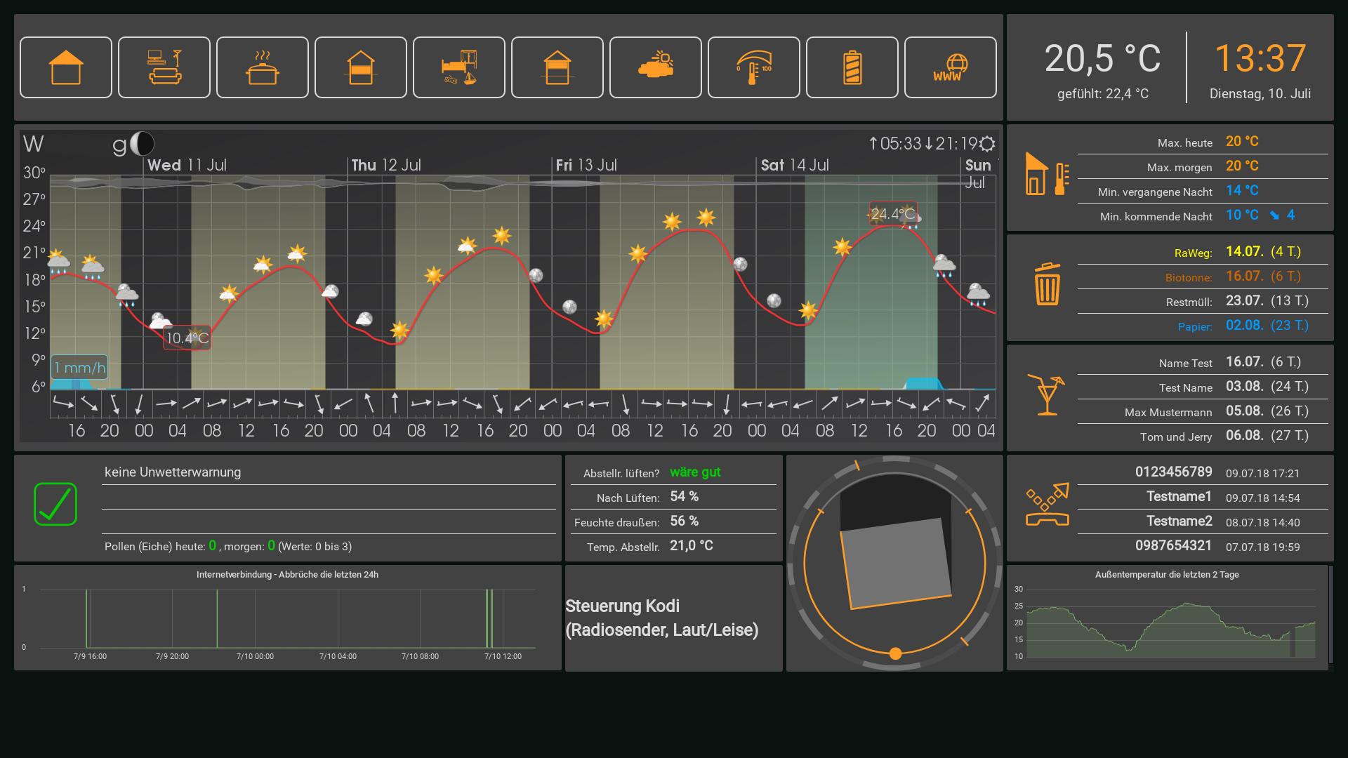

Hi, I’m pretty new to OH and HABPanel (thank you for that great software!), but I’d like to show you the current status of my dashboard…
My house will be built next year (planned with KNX and 1-wire) - so until now I integrated the things I don’t need a the house for :grinning:
The 2 graphs are only for testing - the one in the lower rigth corner will be replaced by a graph showing used and generated power, the graph on the left side will be replaced by “knx-scenes” or important buttons for the living room.
On the right, you see outdoor temperature forecasts. If the change is more than +/- 2 K from today to tomorrow, it will be shown (at the moment the minus 4 K for the night).
Below that, we see the garbage dates and how many days until then. It is sorted by date. If tomorrow is a date, at 17:00 the icons starts blinking until I click it. If it is still blinking 21:00, I get a notification on my phone.
Then, we see birthdays (and also how many days until that date). Nothing special here :grinning:
And finally, I show the missed calls from my Fritzbox. If there is a recorded call, I see a blinking icon, a click plays the call und marks as “old”. Therefore I modified a script I found here in the community (thanks for that!).
The green checkmark on the left shows that there are no weather warnings from DWD (deutscher Wetterdienst). If there are warnings, it looks like this (with a blinking warning symbol):
Ah, and in the midde I calculate if it’s good to ventilate the “basement” - when I have a sensor there in the future, this will be changed, but at the moment I calulate if the humidity inside will be below 65% after ventilating.
The circle shows how the sun will shine on our future house :sunglasses: :grinning: so we can already see at what time we will have sun/shaddow on which side.
Sorry for the long post - next one will be shorter. If someone wants to use a part of it, I will post the code.
