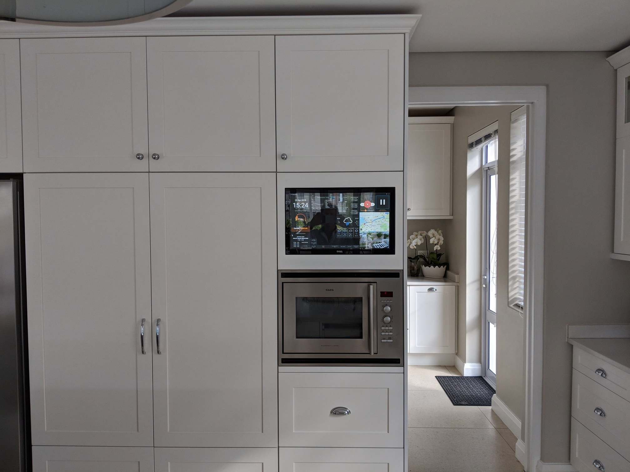

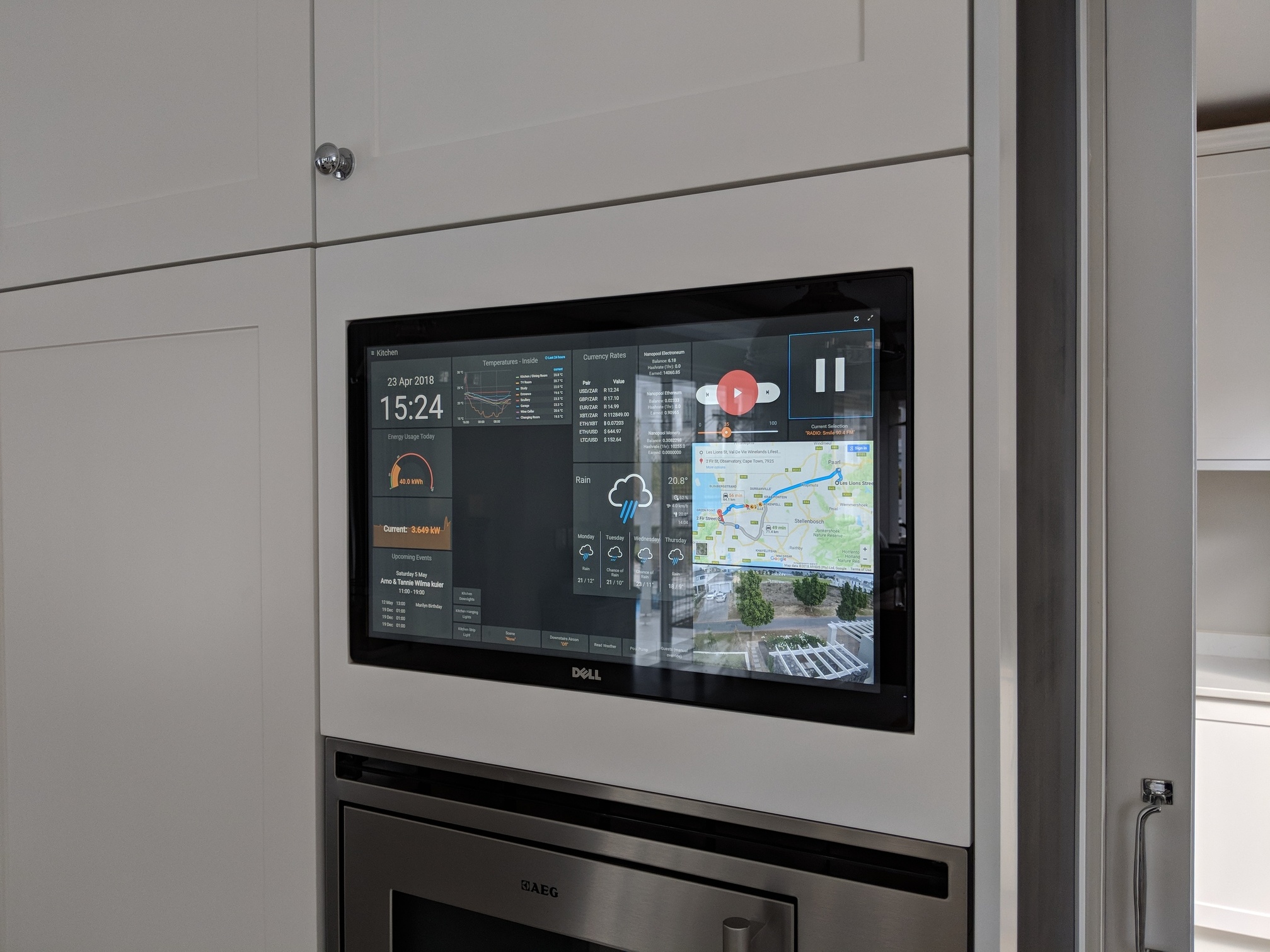

Hi Yoinkz
Thanks - I use a 23" Dell touchscreen (full hd - 1920x1080) hooked up to an Intel Compute Stick. I just run Chrome in kiosk mode.
Here are some other photos of the physical installation:
Wow, this is a high-end solution :+1:
Which Compute stick are you using? Is it fast and snappy using HABPanel?
