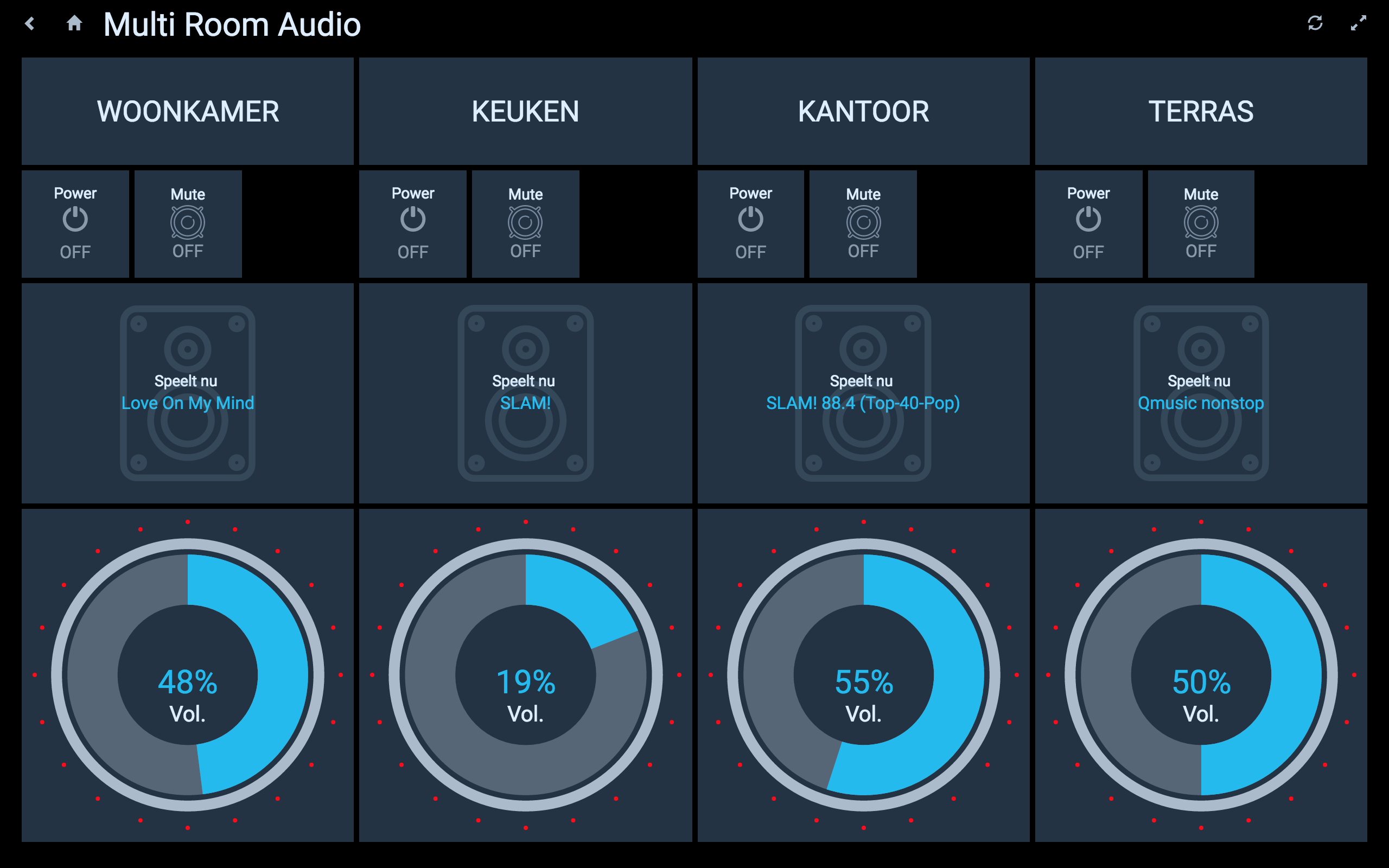

I think it would be awesome if people could maybe use this topic to post screenshots of their panels to give the rest of us inspiration as to what is possible.
My Multiroom Audio Control and my heating control using my Nest thermostat.
My Audio Control, Sensors and Switches. To do: Play/Skip/Pause for iTunes.
