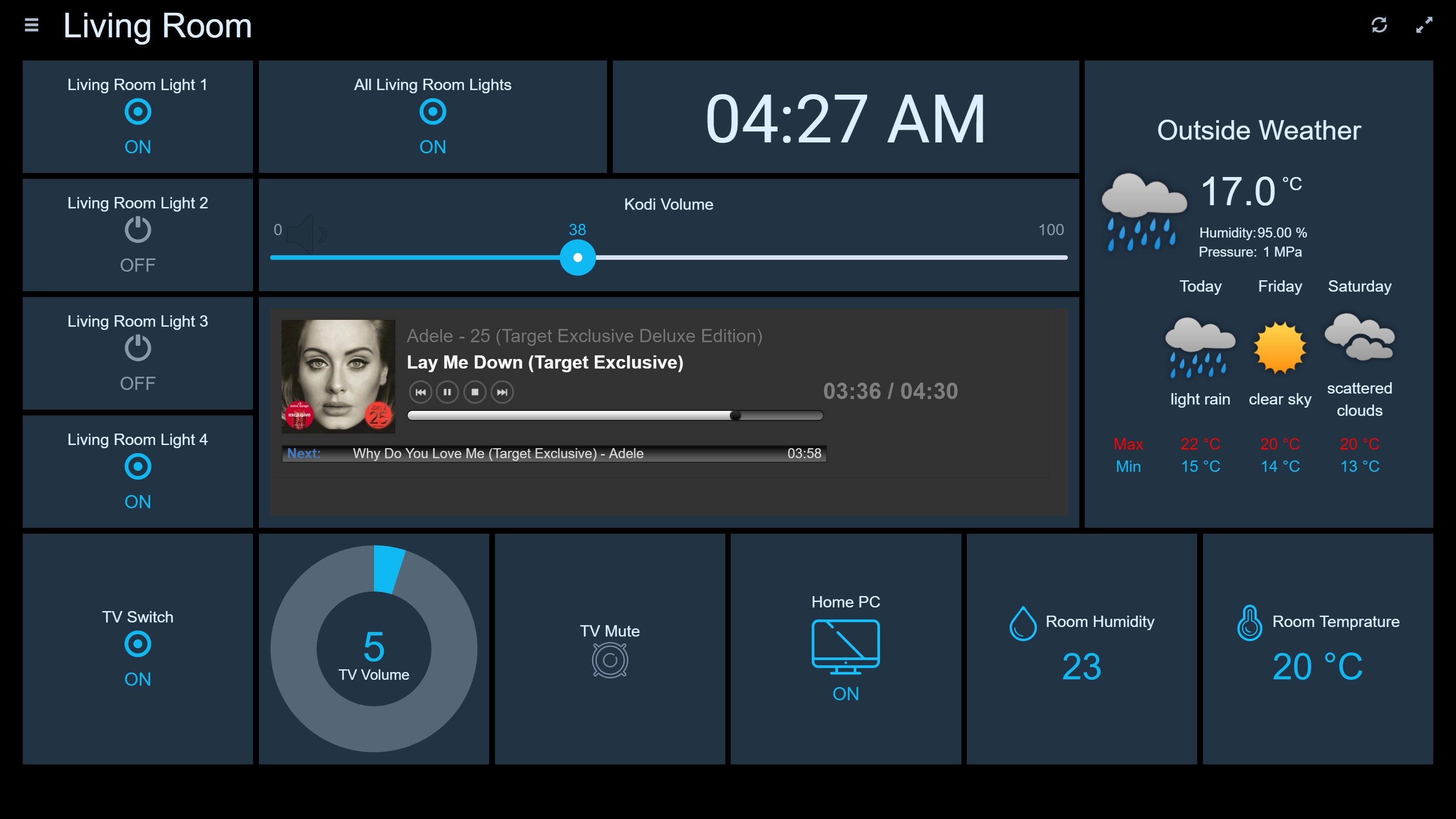

Here is Mine after a couple of hours playing with HABPanel
That’s very cool :slight_smile: I’m hoping to set up some multi-room audio on my dashboard. How did you get the album art into a panel?
And any chance of posting your setup to get the weather looking so good?
Great work
Nice feature display @Basem_AlSaeed, congratulations!
Sorryfor the delay @HomeBoss, that’s not possible at the moment, because external HTML has to be sanitized first (with ngSanitize). It might be included eventually if deemed relevant, but in the meantime you should try converting your HTML table to a JSON object (perhaps through a JS transform), if you manage to do then that it’s fairly easy to use ngRepeat and friends to render it in a template.
@UglyKidJoe thanks for your comment :slight_smile: in fact the weather template is not my work :slight_smile: I used a template shared here
and for the album art, I modified Kodi Web interface and called it in an IFrame from habpanel
