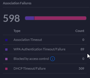

The “unstable wifi routines” are being mentioned on other websites. What I see is the following:
In the Ubiquiti management GUI the switch is flipping (ON-OFF-ON-OFF), visible through a red 0%, then a green 40% (for a few seconds).
Also I see the increasing errorcount:
ubi
The DHCP server is on my FritzBox (7590). The counters were increasing, until the point I unplugged the switches.

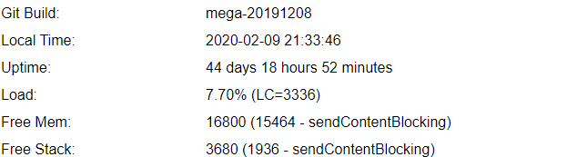

I’m running some ESP8266 devices e.g. to collect temperature and humidity data published via MQTT. I’ve a dedicated 2.4GHz SSID. Most of them are Wemos D1 minis with ESP Easy firmware. and I don’t have stability problems. Here is an example:
09-02-2020 21-38-22
