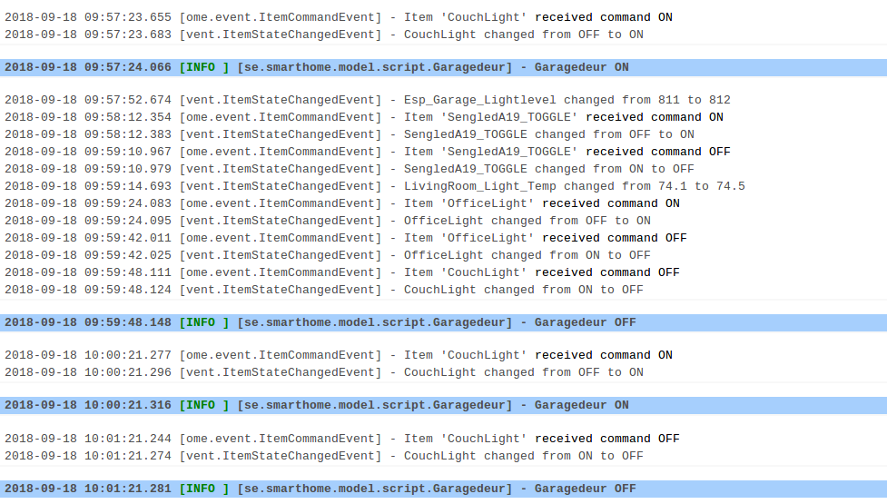

@Kees_van_Gelder I changed the items to work with my setup using this rule.
var Timer garageTimer
rule "Garagedeur telang open"
  Item CouchLight changed to ON or
  Item CouchLight changed to OFF
logInfo("Garagedeur", "Garagedeur "+CouchLight.state)
  if (garageTimer !== null){
      garageTimer.cancel
      garageTimer=null
  if (CouchLight.state == ON){
	garageTimer=createTimer(now.plusMinutes(2)) [ |
	OfficeLight.sendCommand(ON) ]
Everything worked:
