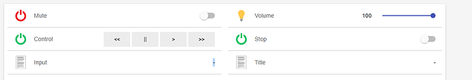

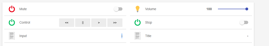

Control:
Greetings Henning

Now I see the root cause. The rendering of Group elements in Sitemaps uses the Default element for your defined Items. In OH2.4 your are probably facing an issue which has been fixed with [ui] Selection widget as default widget for Number or String items with options by lolodomo · Pull Request #1009 · openhab/openhab-core · GitHub.
