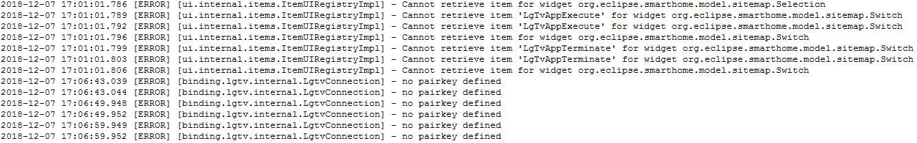

I haven`t restarted my RPI at this point yet - not sure if this should be performed right now or this step is not required.
On openhab app I can`t see any items listed under TV, there is only empty “TV” frame. Not sure exactly where this problem is lying, checking syntax everything appears to be correct.
TV
Checking openhab log I can see the following errors. How do I get per key ?
Searching for an answer on community, I can`t find anyone who would have success with this binding so if we could find solution this would be great tutorial for anyone who is trying to use it. I hope I can find someone who already experienced similar issues before.
Many thanks

Sorry, I got that , just closed the comment, still no items shown.
does the log file still complain about “cannot retrieve item…” ?

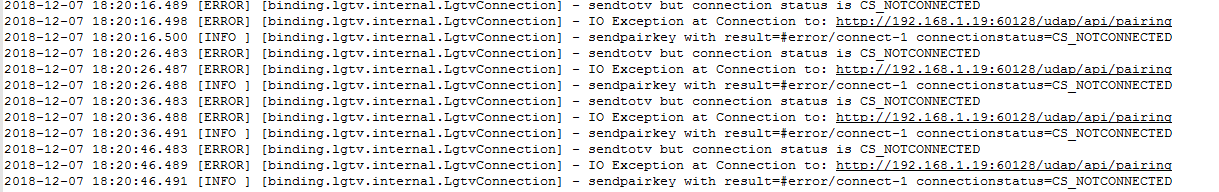

Currently log is displaying error with pair key so still cant connect to tv.
It`s throwing this error every 10 seconds.
Just to mention , I restarted RPI few minutes ago but made no difference.
did you get the pairkey from your TV?
can you post the updated lgtv.cfg file?

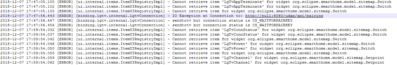

why does your log scream about another IP (.19) than the one configured in your lgtv.cfg (.200)?
check the contents of:
/var/lib/openhab2/config/org/openhab/lgtv.config and post them here
Sorry my bad , copied from notepad device ip is correct as per log .19

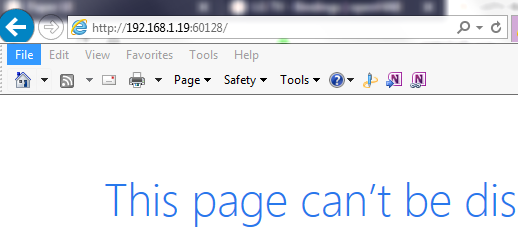

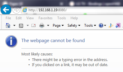

try to access the following 4 URLs from a web browser and report back :slight_smile:
http://192.168.1.19:60128/
http://192.168.1.19:60128/udap/api/pairing
http://192.168.1.19:8080/
http://192.168.1.19:8080/udap/api/pairing
I tried all 4 URL`s but none of them I can access - I tried on two different browsers Internet Explorer and Mozilla Firefox
