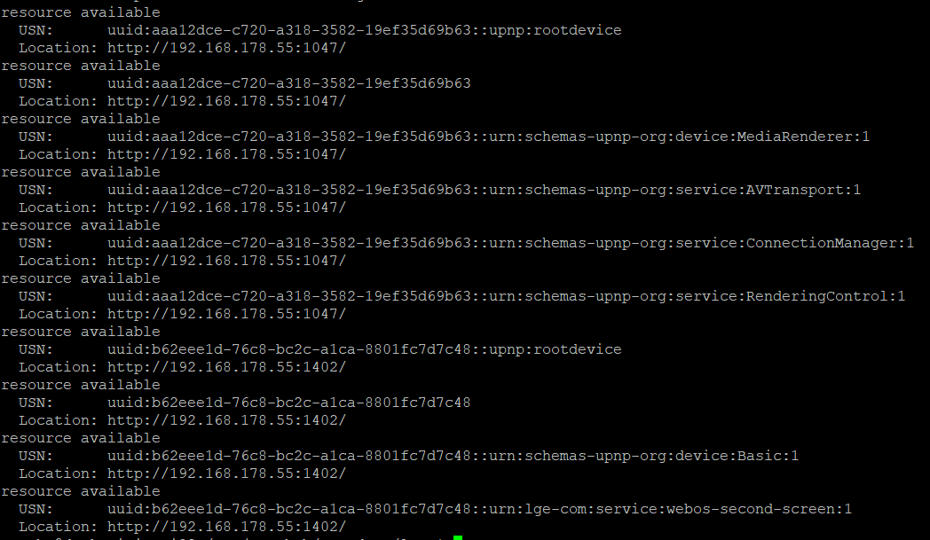

Now most of my equipment is detected, but still no television. Following this superuser.com topic I can find my television (executed on the host), so the broadcast does not seem to be my problem.
Does anyone here have another idea what to do in this situation?
