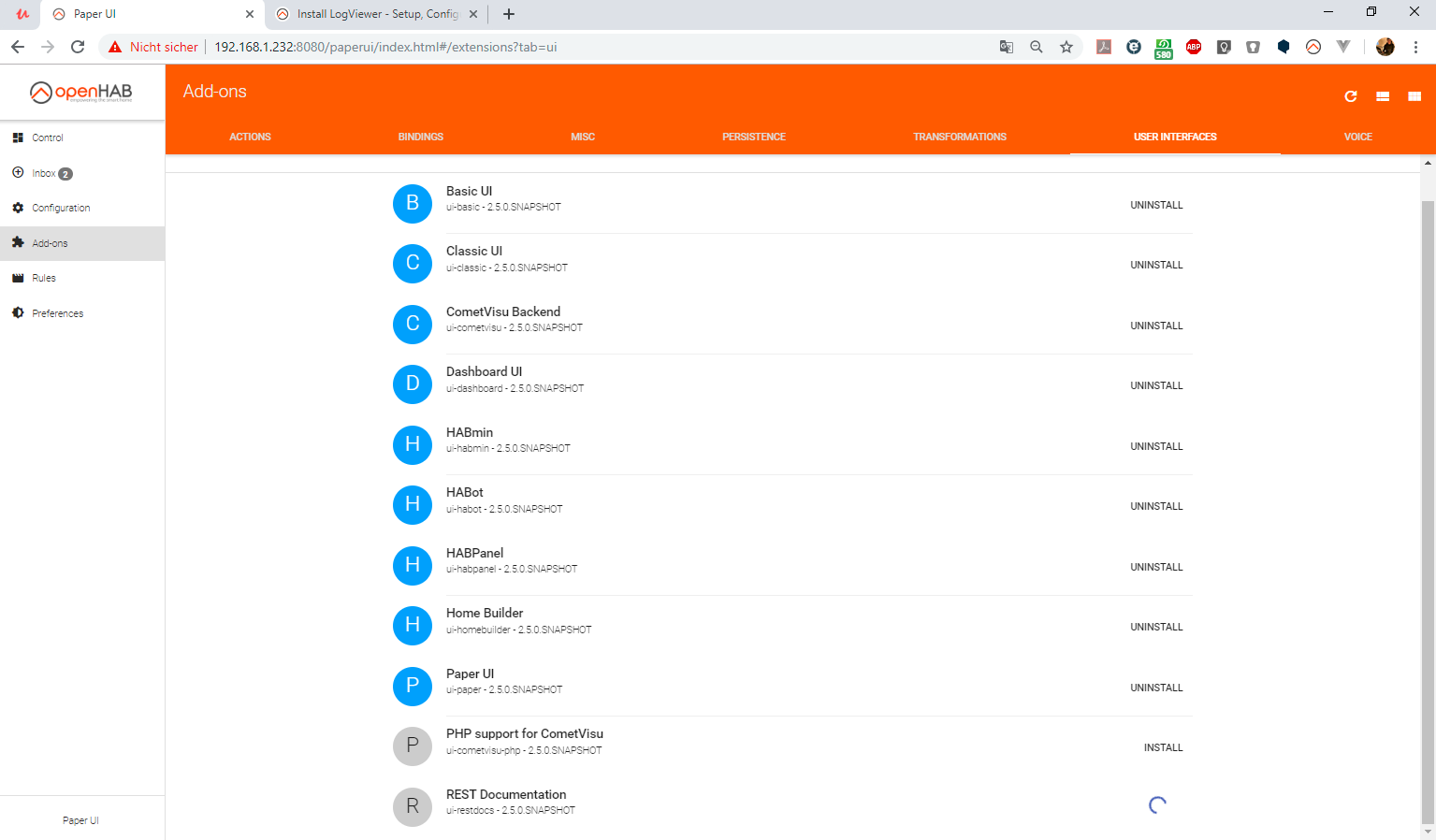

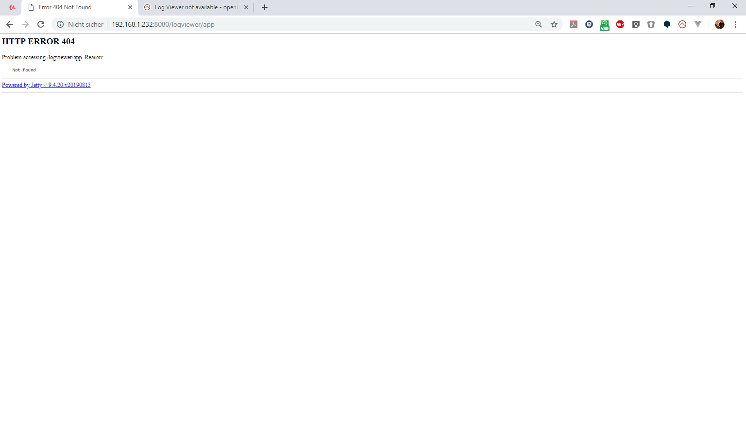

where is the Log Viewer UI in openHAB 2.5? The URL in the second screenshot is not available like it was in openHAB 2.4 i think.
Do I have to install it on my system?

People using openHABian also can install the frontail log viewer from the openhabian-config menu.. OpenHAB itself has no log viewer UI.
I don’t recall logviewer being a part of OH.
If you use openHABian, have a look at frontail, that’s the recommended tool as of today.
(ok, Bruce beat me by a couple of seconds)
And you beat me before I could add a frontail link.
https://www.npmjs.com/package/frontail
thanks for your great work in the community @mstormi @Bruce_Osborne :slight_smile:
