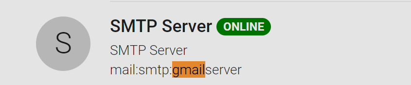

After upgrading to 2.5,1 stable, I am trying to use the new Mail binding. I do not have the old Mail action installed. The Mail thing is green.
When I try to send an email using the sample from the official example I get the following error

val mailActions = getActions(“mail”,“mail:smtp:gmailserver”)
mailActions.sendMail(“xxxxx@yahoo.com”, “test title”, “test email”)

Edit: Solved. It turns out that the 3rd party access in google settings is still required. I thought I had it enabled but I had done it for another google account, not related to the account configured in openhab.
