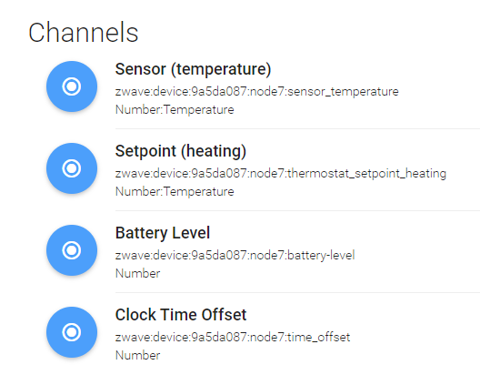

Discovery worked quite well and fast and I got this

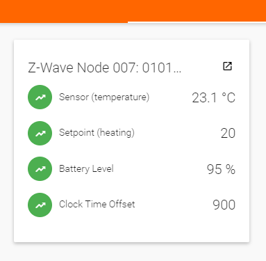

Also in paperUI I got some usefull value that I’d like to present into a . sitemap file:

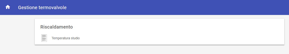

But at the end the only thing that I see in basic UI is:
any ideas where is the error?

Does the Channel for the Temperature show that it needs a Number Item or a Number:Temperature?

In both the Item label and the sitemap label, you have suppressed showing the actual temperature. See Items | openHAB. When you define the label in both places, the label definition in the sitemap will take precedence.

2
The channel temperature reports the following:
zwave:device:9a5da087:node7:sensor_temperature
Number:Temperature

The errors mean that you have an Item on your sitemap that doesn’t exist. Look for errors when your .items file is loaded. Double check that the Item name is identical (including case) between the sitemap and the .items file and the sitemap. Look in the Item’s config in PaperUI to make sure the Item is listed.
You need to define the Item as a Number:Temperature. You can’t use just a plain old Number.
