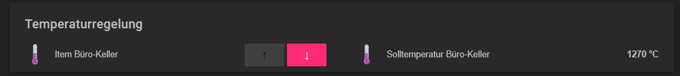

I got the following problem. I visualize a threshold of a heater. The problem is that the value isn`t shown in the way I want. The value that I receive from my home automation system is “1270 °C” and that’s how it is saved in its system. In my sitemap I want it to be shown as “27 °C” or “27.0 °C”. Is there a way to achieve this? Maybe by using rule-engine?

		Switch item=MeinZuhause_Temperaturregler_Item label="Item Büro-Keller" icon="temperature" mappings=[ON="↑", OFF="↓"]
		Text item=MeinZuhause_Temperaturregler_Item_Anzeige label="Solltemperatur Büro-Keller" icon="temperature"

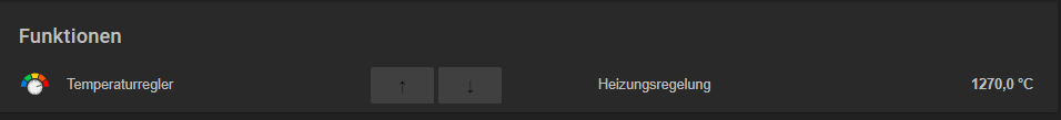

[%.1f °C] This will results in something like this

No its not, if i change the threshold to -1 °C it is shown as 990 °C
“1270°C” is really “27 °C”. I tried your solution but the result was, that it only adds one digit :confused:
Did you try making the item a number?
Number MeinZuhause_Temperaturregler_Item_Anzeige "Item [%.1f °C]" {lcn="[myhome:THRESHOLD_VALUE.0.0.1.1]"}
Yep already tried it but forgot to mention it. In the figure above it is already defined as a number.
