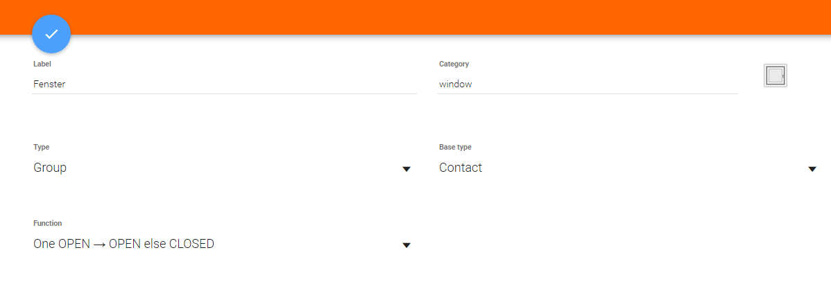

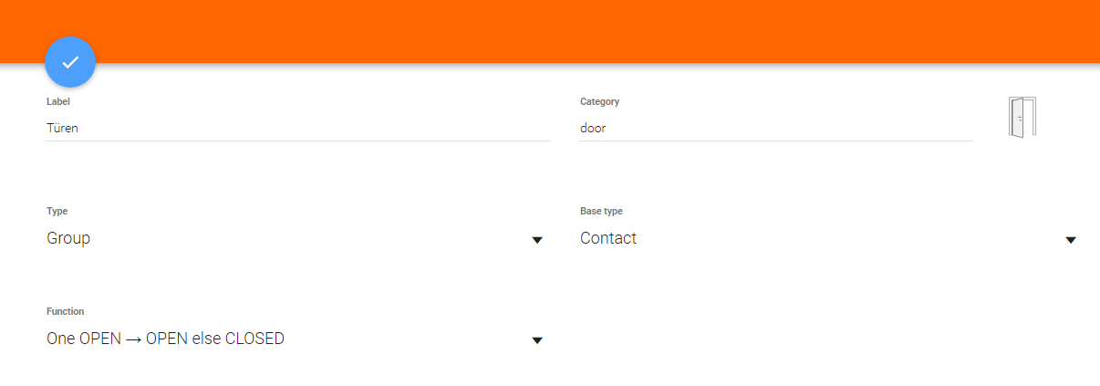

I have two contact groups for windows (G_windows) and doors (G_Doors) (Yes, one uppercase, one lowercase…):
The groups work correctly.
If I open a door or a window, the icon immediately changes from closed to open, if at least one door/window is open.

The G_doors group itself is working, as the icon changes as soon as the first door is opened.
