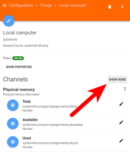

They are advanced so click the “Show More” button to show them :slight_smile:
They also show after clicking the “Show More” button and are just above those load channels:
Jesus - big thanks. stupid mistake. Yes now i see the additional groups…
