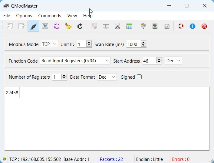

i did the same with my Viesmann Vitogate 300, but i only got some values back with modbus.
I tested the register with qmodbus too and it shows the right values.

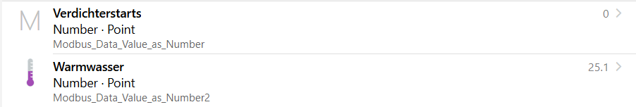

But when i put this inputregister on OH (3.4.4 or 4.2.2) i only get back a “0”
I tested since two days and nothing works.
I created everything over the gui and then over visualstudiocode but only same items get values.
I have also successfully integrated my Sungrow inverter but the heating just doesn’t work yet.
Does anyone else have an idea?

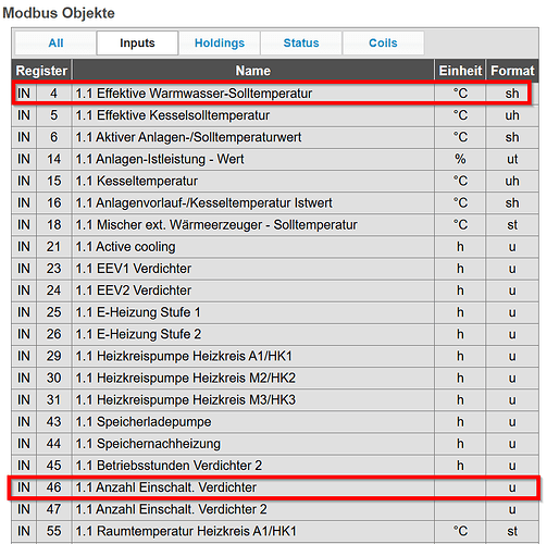

Bridge modbus:tcp:WP [ host="192.168.5.155", port=502 ] {
     Bridge poller WPWasser [ start=4, length=10, refresh=5000, type="input" ] {
        //Warmwassertemp
        Thing data WPWarmwasser [readStart="4", readValueType="int16", readTransform="JS(div100.js)"]
    Bridge poller WPGeraet [start=40, length=10, refresh=5000, type="input"] {
        //Anzahl der Verdichterstarts
        Thing data Verdichterstarts [readStart="46", readValueType="uint16", readTransform="default"]
So everything is online? No errors in the log?
Why does your poller start from address 40?
Try to start directly from 46.
Hi, my thought.
try
Thing data Verdichterstarts [readStart="46", readValueType="uint16"]
Without readTransform
Or readValueType as int16, not uint16
