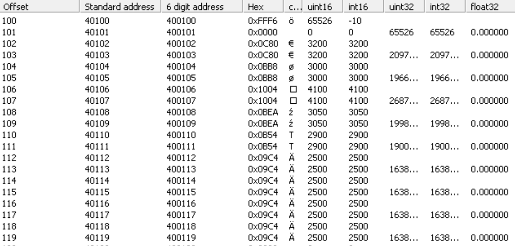

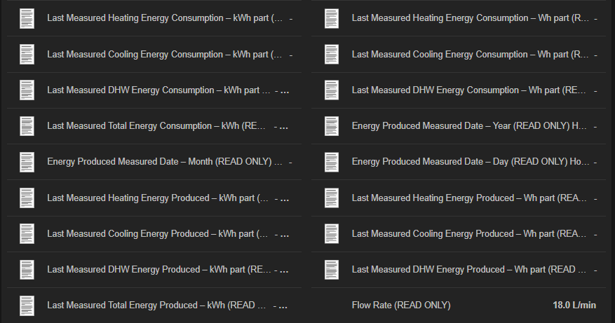

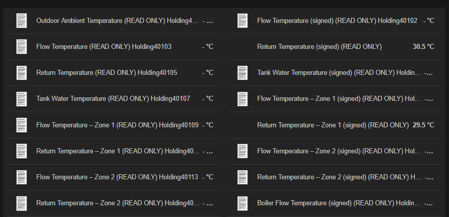

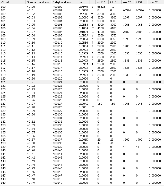

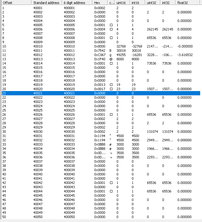

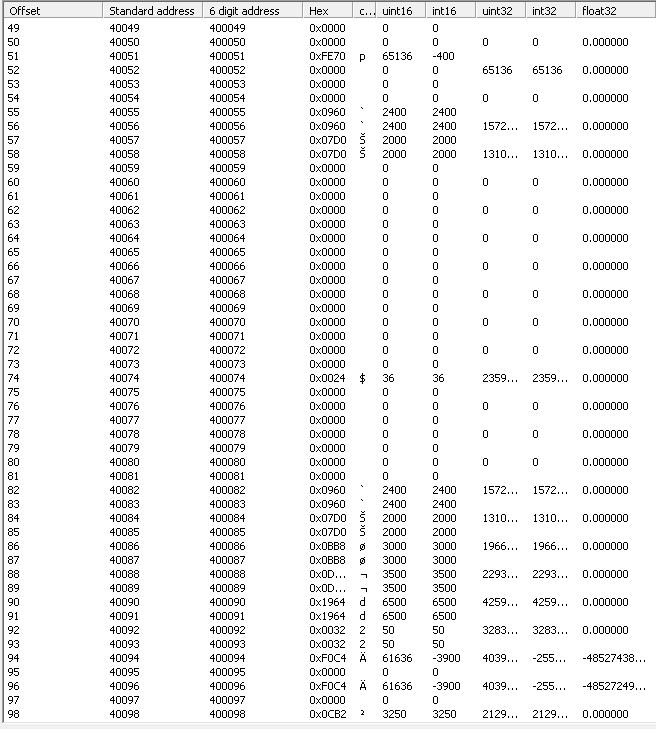

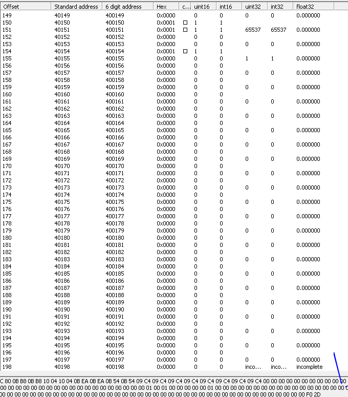

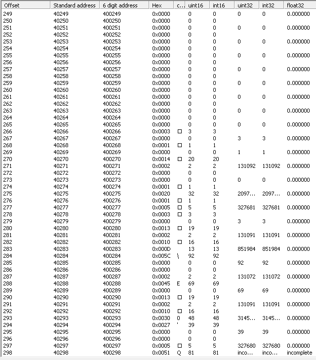

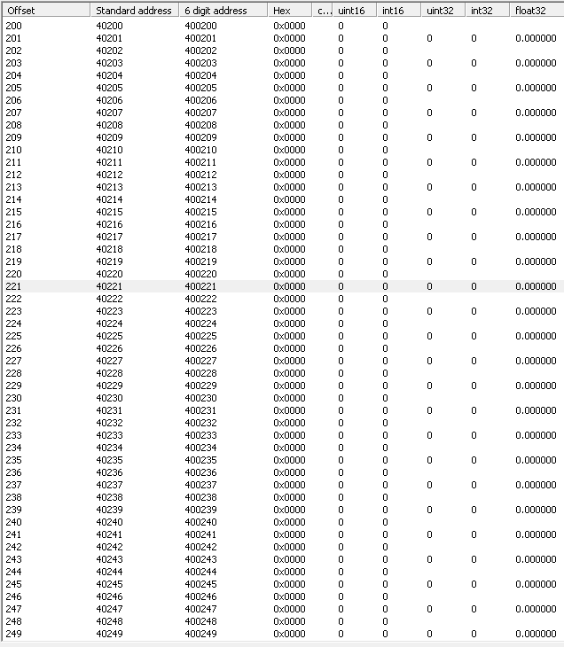

Hi. I’m struggling to get my modbus v2 binding data running.
I’m trying to pull holding registers data which I can see with CAS Modbus scanner.

Here is my configuration (under openHAB 2.4.0-1 (Release Build)):
modbus.things:
Bridge modbus:serial:slave1 [ port="/dev/ttyUSB0" ,id=1 , baud=9600, stopBits="1.0", parity="none", dataBits=8, encoding="rtu" ] {
Bridge poller HoldingSlave1 [ start=0, length=100, refresh=1000, type="holding" ]{
Thing data Holding40005 [ readStart="4", readValueType="uint16", readTransform="default", writeStart="4", writeValueType="uint16", writeType="holding" ] //Modbus Slave ID //OK
Thing data Holding40006 [ readStart="5", readValueType="uint16", readTransform="default", writeStart="5", writeValueType="uint16", writeType="holding" ] //Modbus RS-485 Baud Rate //OK
Thing data Holding40007 [ readStart="6", readValueType="uint16", readTransform="default", writeStart="6", writeValueType="uint16", writeType="holding" ] //RS-485 Parity Type //OK
//Thing data Holding40008 [ readStart="7", readValueType="uint16", readTransform="default", writeStart="7", writeValueType="uint16", writeType="holding" ] //
//Thing data Holding40009 [ readStart="8", readValueType="uint16", readTransform="default", writeStart="8", writeValueType="uint16", writeType="holding" ] //
Thing data Holding40010 [ readStart="9", readValueType="uint16", readTransform="default", writeStart="9", writeValueType="uint16", writeType="holding" ] //Fault/Error Code (hex) [READ ONLY]
Thing data Holding40011 [ readStart="10", readValueType="uint16", readTransform="default", writeStart="10", writeValueType="uint16", writeType="holding" ] //MelcoBEMS MINI (A1M) Firmware Version [READ ONLY]
//Thing data Holding40012 [ readStart="11", readValueType="uint16", readTransform="default", writeStart="11", writeValueType="uint16", writeType="holding" ] //Modbus Comms Counter [READ ONLY]
Thing data Holding40013 [ readStart="12", readValueType="uint16", readTransform="default", writeStart="12", writeValueType="uint16", writeType="holding" ] //Fault Code (decimal) [READ ONLY]
Thing data Holding40014 [ readStart="13", readValueType="uint16", readTransform="default", writeStart="13", writeValueType="uint16", writeType="holding" ] //System Type Detected [READ ONLY]
//Thing data Holding40015 [ readStart="14", readValueType="uint16", readTransform="default", writeStart="14", writeValueType="uint16", writeType="holding" ] //
//Thing data Holding40016 [ readStart="15", readValueType="uint16", readTransform="default", writeStart="15", writeValueType="uint16", writeType="holding" ] //
//Thing data Holding40017 [ readStart="16", readValueType="uint16", readTransform="default", writeStart="16", writeValueType="uint16", writeType="holding" ] //
//Thing data Holding40018 [ readStart="17", readValueType="uint16", readTransform="default", writeStart="17", writeValueType="uint16", writeType="holding" ] //
//Thing data Holding40019 [ readStart="18", readValueType="uint16", readTransform="default", writeStart="18", writeValueType="uint16", writeType="holding" ] //
//Thing data Holding40020 [ readStart="19", readValueType="uint16", readTransform="default", writeStart="19", writeValueType="uint16", writeType="holding" ] //
//Thing data Holding40021 [ readStart="20", readValueType="uint16", readTransform="default", writeStart="20", writeValueType="uint16", writeType="holding" ] //
//Thing data Holding40022 [ readStart="21", readValueType="uint16", readTransform="default", writeStart="21", writeValueType="uint16", writeType="holding" ] //
//Thing data Holding40023 [ readStart="22", readValueType="uint16", readTransform="default", writeStart="22", writeValueType="uint16", writeType="holding" ] //
//Thing data Holding40024 [ readStart="23", readValueType="uint16", readTransform="default", writeStart="23", writeValueType="uint16", writeType="holding" ] //
//Thing data Holding40025 [ readStart="24", readValueType="uint16", readTransform="default", writeStart="24", writeValueType="uint16", writeType="holding" ] //
Thing data Holding40026 [ readStart="25", readValueType="uint16", readTransform="default", writeStart="25", writeValueType="uint16", writeType="holding" ] //System On/Off
Thing data Holding40027 [ readStart="26", readValueType="uint16", readTransform="default", writeStart="26", writeValueType="uint16", writeType="holding" ] //Operating Mode
Thing data Holding40028 [ readStart="27", readValueType="uint16", readTransform="default", writeStart="27", writeValueType="uint16", writeType="holding" ] //Operating Mode (DHW)
Thing data Holding40029 [ readStart="28", readValueType="uint16", readTransform="default", writeStart="28", writeValueType="uint16", writeType="holding" ] //A/C Mode – Zone 1
Thing data Holding40030 [ readStart="29", readValueType="uint16", readTransform="default", writeStart="29", writeValueType="uint16", writeType="holding" ] //A/C Mode – Zone 2
Thing data Holding40031 [ readStart="30", readValueType="uint16", readTransform="JS(divide100.js)", writeStart="30", writeValueType="uint16", writeType="holding" ] //Set Tank Water Temperature (signed)
Thing data Holding40032 [ readStart="31", readValueType="uint16", readTransform="JS(divide100.js)", writeStart="31", writeValueType="uint16", writeType="holding" ] //Set Tank Water Temperature
Thing data Holding40033 [ readStart="32", readValueType="uint16", readTransform="JS(divide100.js)", writeStart="32", writeValueType="uint16", writeType="holding" ] //H/C Thermostat Target Temperature – Zone 1 (signed)
Thing data Holding40034 [ readStart="33", readValueType="uint16", readTransform="JS(divide100.js)", writeStart="33", writeValueType="uint16", writeType="holding" ] //H/C Thermostat Target Temperature – Zone 1
Thing data Holding40035 [ readStart="34", readValueType="uint16", readTransform="JS(divide100.js)", writeStart="34", writeValueType="uint16", writeType="holding" ] //H/C Thermostat Target Temperature – Zone 2 (signed)
Thing data Holding40036 [ readStart="35", readValueType="uint16", readTransform="JS(divide100.js)", writeStart="35", writeValueType="uint16", writeType="holding" ] //H/C Thermostat Target Temperature – Zone 2
Thing data Holding40037 [ readStart="36", readValueType="uint16", readTransform="default", writeStart="36", writeValueType="uint16", writeType="holding" ] //MRC Prohibit
Thing data Holding40038 [ readStart="37", readValueType="uint16", readTransform="default", writeStart="37", writeValueType="uint16", writeType="holding" ] //Force DHW
Thing data Holding40039 [ readStart="38", readValueType="uint16", readTransform="default", writeStart="38", writeValueType="uint16", writeType="holding" ] //Holiday
Thing data Holding40040 [ readStart="39", readValueType="uint16", readTransform="default", writeStart="39", writeValueType="uint16", writeType="holding" ] //DHW On Prohibit
Thing data Holding40041 [ readStart="40", readValueType="uint16", readTransform="default", writeStart="40", writeValueType="uint16", writeType="holding" ] //Heating On Prohibit – Zone 1
Thing data Holding40042 [ readStart="41", readValueType="uint16", readTransform="default", writeStart="41", writeValueType="uint16", writeType="holding" ] //Cooling On Prohibit – Zone 1
Thing data Holding40043 [ readStart="42", readValueType="uint16", readTransform="default", writeStart="42", writeValueType="uint16", writeType="holding" ] //Heating On Prohibit – Zone 2
Thing data Holding40044 [ readStart="43", readValueType="uint16", readTransform="default", writeStart="43", writeValueType="uint16", writeType="holding" ] //Cooling On Prohibit – Zone 2
//Thing data Holding40045 [ readStart="44", readValueType="uint16", readTransform="default", writeStart="44", writeValueType="uint16", writeType="holding" ] //Unused
Thing data Holding40046 [ readStart="45", readValueType="uint16", readTransform="default", writeStart="45", writeValueType="uint16", writeType="holding" ] //Capacity Mode
Thing data Holding40047 [ readStart="46", readValueType="uint16", readTransform="default", writeStart="46", writeValueType="uint16", writeType="holding" ] //Capacity Control Ratio
Thing data Holding40048 [ readStart="47", readValueType="uint16", readTransform="default", writeStart="47", writeValueType="uint16", writeType="holding" ] //Fan Mode
Thing data Holding40049 [ readStart="48", readValueType="uint16", readTransform="default", writeStart="48", writeValueType="uint16", writeType="holding" ] //Current Hour
Thing data Holding40050 [ readStart="49", readValueType="uint16", readTransform="default", writeStart="49", writeValueType="uint16", writeType="holding" ] //Current Minute
Thing data Holding40051 [ readStart="50", readValueType="int16", readTransform="JS(divide10.js)", writeStart="50", writeValueType="int16", writeType="holding" ] //Outdoor Temperature By BMS (signed)
Thing data Holding40052 [ readStart="51", readValueType="int16", readTransform="JS(divide10.js)", writeStart="51", writeValueType="int16", writeType="holding" ] //Outdoor Temperature By BMS
Thing data Holding40053 [ readStart="52", readValueType="uint16", readTransform="JS(divide100.js)", writeStart="52", writeValueType="uint16", writeType="holding" ] //Setting Water Temperature (signed)
Thing data Holding40054 [ readStart="53", readValueType="uint16", readTransform="JS(divide100.js)", writeStart="53", writeValueType="uint16", writeType="holding" ] //Setting Water Temperature
Thing data Holding40055 [ readStart="54", readValueType="uint16", readTransform="JS(divide100.js)", writeStart="54", writeValueType="uint16", writeType="holding" ] //Thermostat Target Temperature – Zone 1 (signed)
Thing data Holding40056 [ readStart="55", readValueType="uint16", readTransform="JS(divide100.js)", writeStart="55", writeValueType="uint16", writeType="holding" ] //Thermostat Target Temperature – Zone 1
Thing data Holding40057 [ readStart="56", readValueType="uint16", readTransform="JS(divide100.js)", writeStart="56", writeValueType="uint16", writeType="holding" ] //Thermostat Target Temperature – Zone 2 (signed)
Thing data Holding40058 [ readStart="57", readValueType="uint16", readTransform="JS(divide100.js)", writeStart="57", writeValueType="uint16", writeType="holding" ] //Thermostat Target Temperature – Zone 2 (signed)
Thing data Holding40059 [ readStart="58", readValueType="uint16", readTransform="default", writeStart="58", writeValueType="uint16", writeType="holding" ] //HC Control Type
//Thing data Holding40060 [ readStart="59", readValueType="uint16", readTransform="default", writeStart="59", writeValueType="uint16", writeType="holding" ] //
//Thing data Holding40061 [ readStart="60", readValueType="uint16", readTransform="default", writeStart="60", writeValueType="uint16", writeType="holding" ] //
//Thing data Holding40062 [ readStart="61", readValueType="uint16", readTransform="default", writeStart="61", writeValueType="uint16", writeType="holding" ] //
//Thing data Holding40063 [ readStart="62", readValueType="uint16", readTransform="default", writeStart="62", writeValueType="uint16", writeType="holding" ] //
//Thing data Holding40064 [ readStart="63", readValueType="uint16", readTransform="default", writeStart="63", writeValueType="uint16", writeType="holding" ] //
//Thing data Holding40065 [ readStart="64", readValueType="uint16", readTransform="default", writeStart="64", writeValueType="uint16", writeType="holding" ] //
//Thing data Holding40066 [ readStart="65", readValueType="uint16", readTransform="default", writeStart="65", writeValueType="uint16", writeType="holding" ] //
Thing data Holding40067 [ readStart="66", readValueType="uint16", readTransform="default", writeStart="66", writeValueType="uint16", writeType="holding" ] //Own Refrigerant Address [READ ONLY]
Thing data Holding40068 [ readStart="67", readValueType="uint16", readTransform="default", writeStart="67", writeValueType="uint16", writeType="holding" ] //Defrost [READ ONLY]
Thing data Holding40069 [ readStart="68", readValueType="uint16", readTransform="default", writeStart="68", writeValueType="uint16", writeType="holding" ] //Residual Heat Removal [READ ONLY]
Thing data Holding40070 [ readStart="69", readValueType="uint16", readTransform="default", writeStart="69", writeValueType="uint16", writeType="holding" ] //Refrigerant Error Info [READ ONLY]
Thing data Holding40071 [ readStart="70", readValueType="uint16", readTransform="default", writeStart="70", writeValueType="uint16", writeType="holding" ] //7-Segment Display Error Code Digit 1 [READ ONLY]
Thing data Holding40072 [ readStart="71", readValueType="uint16", readTransform="default", writeStart="71", writeValueType="uint16", writeType="holding" ] //7-Segment Display Error Code Digit 2 [READ ONLY]
Thing data Holding40073 [ readStart="72", readValueType="uint16", readTransform="default", writeStart="72", writeValueType="uint16", writeType="holding" ] //Status Of Heating [READ ONLY]
Thing data Holding40074 [ readStart="73", readValueType="uint16", readTransform="default", writeStart="73", writeValueType="uint16", writeType="holding" ] //Heat Pump Frequency – Master [READ ONLY]
Thing data Holding40075 [ readStart="74", readValueType="uint16", readTransform="default", writeStart="74", writeValueType="uint16", writeType="holding" ] //Heat Pump Frequency – Slave 1 [READ ONLY]
Thing data Holding40076 [ readStart="75", readValueType="uint16", readTransform="default", writeStart="75", writeValueType="uint16", writeType="holding" ] //Heat Pump Frequency – Slave 2 [READ ONLY]
Thing data Holding40077 [ readStart="76", readValueType="uint16", readTransform="default", writeStart="76", writeValueType="uint16", writeType="holding" ] //Heat Pump Frequency – Slave 3 [READ ONLY]
Thing data Holding40078 [ readStart="77", readValueType="uint16", readTransform="default", writeStart="77", writeValueType="uint16", writeType="holding" ] //Heat Pump Frequency – Slave 4 [READ ONLY]
Thing data Holding40079 [ readStart="78", readValueType="uint16", readTransform="default", writeStart="78", writeValueType="uint16", writeType="holding" ] //Heat Pump Frequency – Slave 5 [READ ONLY]
Thing data Holding40080 [ readStart="79", readValueType="uint16", readTransform="default", writeStart="79", writeValueType="uint16", writeType="holding" ] //Heat Pump Frequency – Slave 6 [READ ONLY]
Thing data Holding40081 [ readStart="80", readValueType="uint16", readTransform="default", writeStart="80", writeValueType="uint16", writeType="holding" ] //Heat Source Status [READ ONLY]
Thing data Holding40082 [ readStart="81", readValueType="uint16", readTransform="JS(divide100.js)", writeStart="81", writeValueType="uint16", writeType="holding" ] //Temperature Setpoint – Zone 1 (signed) [READ ONLY]
Thing data Holding40083 [ readStart="82", readValueType="uint16", readTransform="JS(divide100.js)", writeStart="82", writeValueType="uint16", writeType="holding" ] //Temperature Setpoint – Zone 1 [READ ONLY]
Thing data Holding40084 [ readStart="83", readValueType="uint16", readTransform="JS(divide100.js)", writeStart="83", writeValueType="uint16", writeType="holding" ] //Temperature Setpoint – Zone 2 (signed) [READ ONLY]
Thing data Holding40085 [ readStart="84", readValueType="uint16", readTransform="JS(divide100.js)", writeStart="84", writeValueType="uint16", writeType="holding" ] //Temperature Setpoint – Zone 2 [READ ONLY]
Thing data Holding40086 [ readStart="85", readValueType="uint16", readTransform="JS(divide100.js)", writeStart="85", writeValueType="uint16", writeType="holding" ] //Flow Temperature Setpoint – Zone 1 (signed) [READ ONLY]
Thing data Holding40087 [ readStart="86", readValueType="uint16", readTransform="JS(divide100.js)", writeStart="86", writeValueType="uint16", writeType="holding" ] //Flow Temperature Setpoint – Zone 1 [READ ONLY]
Thing data Holding40088 [ readStart="87", readValueType="uint16", readTransform="JS(divide100.js)", writeStart="87", writeValueType="uint16", writeType="holding" ] //Flow Temperature Setpoint – Zone 2 (signed) [READ ONLY]
Thing data Holding40089 [ readStart="88", readValueType="uint16", readTransform="JS(divide100.js)", writeStart="88", writeValueType="uint16", writeType="holding" ] //Flow Temperature Setpoint – Zone 2 [READ ONLY]
Thing data Holding40090 [ readStart="89", readValueType="uint16", readTransform="JS(divide100.js)", writeStart="89", writeValueType="uint16", writeType="holding" ] //Legionella Temperature Setpoint (signed) [READ ONLY]
Thing data Holding40091 [ readStart="90", readValueType="uint16", readTransform="JS(divide100.js)", writeStart="90", writeValueType="uint16", writeType="holding" ] //Legionella Temperature Setpoint [READ ONLY]
Thing data Holding40092 [ readStart="91", readValueType="uint16", readTransform="JS(divide100.js)", writeStart="91", writeValueType="uint16", writeType="holding" ] //DHW Temperature Drop (signed) [READ ONLY]
Thing data Holding40093 [ readStart="92", readValueType="uint16", readTransform="JS(divide10.js)", writeStart="92", writeValueType="uint16", writeType="holding" ] //DHW Temperature Drop [READ ONLY]
Thing data Holding40094 [ readStart="93", readValueType="uint16", readTransform="JS(divide10.js)", writeStart="93", writeValueType="uint16", writeType="holding" ] //Room Temperature – Zone 1 (signed) [READ ONLY]
Thing data Holding40095 [ readStart="94", readValueType="uint16", readTransform="JS(divide100.js)", writeStart="94", writeValueType="uint16", writeType="holding" ] //Room Temperature – Zone 1 [READ ONLY]
Thing data Holding40096 [ readStart="95", readValueType="uint16", readTransform="JS(divide100.js)", writeStart="95", writeValueType="uint16", writeType="holding" ] //Room Temperature – Zone 2 (signed) [READ ONLY]
Thing data Holding40097 [ readStart="96", readValueType="uint16", readTransform="JS(divide100.js)", writeStart="96", writeValueType="uint16", writeType="holding" ] //Room Temperature – Zone 2 [READ ONLY]
Thing data Holding40098 [ readStart="97", readValueType="uint16", readTransform="JS(divide100.js)", writeStart="97", writeValueType="uint16", writeType="holding" ] //Refrigerant Liquid Temperature (signed) [READ ONLY]
Thing data Holding40099 [ readStart="98", readValueType="uint16", readTransform="JS(divide100.js)", writeStart="98", writeValueType="uint16", writeType="holding" ] //Refrigerant Liquid Temperature [READ ONLY]
Thing data Holding40100 [ readStart="99", readValueType="uint16", readTransform="JS(divide10.js)", writeStart="99", writeValueType="uint16", writeType="holding" ] //Outdoor Ambient Temperature (signed) [READ ONLY]

Thing data Holding40114 [ readStart="113", readValueType="uint16", readTransform="JS(divide100.js)", writeStart="113", writeValueType="uint16", writeType="holding" ] //Return Temperature – Zone 2 (signed) (READ ONLY)
Thing data Holding40115 [ readStart="114", readValueType="uint16", readTransform="JS(divide100.js)", writeStart="114", writeValueType="uint16", writeType="holding" ] //Return Temperature – Zone 2 (READ ONLY)
Thing data Holding40116 [ readStart="115", readValueType="uint16", readTransform="JS(divide100.js)", writeStart="115", writeValueType="uint16", writeType="holding" ] //Boiler Flow Temperature (signed) (READ ONLY)
Thing data Holding40117 [ readStart="116", readValueType="uint16", readTransform="JS(divide100.js)", writeStart="116", writeValueType="uint16", writeType="holding" ] //Boiler Flow Temperature (READ ONLY)
Thing data Holding40118 [ readStart="117", readValueType="uint16", readTransform="JS(divide100.js)", writeStart="117", writeValueType="uint16", writeType="holding" ] //Boiler Return Temperature (signed) (READ ONLY)
Thing data Holding40119 [ readStart="118", readValueType="uint16", readTransform="JS(divide100.js)", writeStart="118", writeValueType="uint16", writeType="holding" ] //Boiler Return Temperature (READ ONLY)
Thing data Holding40120 [ readStart="119", readValueType="int16", readTransform="default", writeStart="119", writeValueType="int16", writeType="holding" ] //Room Thermo 1 (IN1) (READ ONLY)
Thing data Holding40121 [ readStart="120", readValueType="uint16", readTransform="default", writeStart="120", writeValueType="uint16", writeType="holding" ] //Room Thermo 2 (IN6) (READ ONLY)
Thing data Holding40122 [ readStart="121", readValueType="uint16", readTransform="default", writeStart="121", writeValueType="uint16", writeType="holding" ] //Flow SW1 (IN2) (READ ONLY)
Thing data Holding40123 [ readStart="122", readValueType="uint16", readTransform="default", writeStart="122", writeValueType="uint16", writeType="holding" ] //Flow SW2 (IN3) (READ ONLY)
Thing data Holding40124 [ readStart="123", readValueType="uint16", readTransform="default", writeStart="123", writeValueType="uint16", writeType="holding" ] //Flow SW3 (IN7) (READ ONLY)
Thing data Holding40125 [ readStart="124", readValueType="uint16", readTransform="default", writeStart="124", writeValueType="uint16", writeType="holding" ] //Demand (IN4) (READ ONLY)
Thing data Holding40126 [ readStart="125", readValueType="uint16", readTransform="default", writeStart="125", writeValueType="uint16", writeType="holding" ] //Outdoor Thermo (IN5) (READ ONLY)
Thing data Holding40127 [ readStart="126", readValueType="uint16", readTransform="default", writeStart="126", writeValueType="uint16", writeType="holding" ] //DIP Switch SW2 (READ ONLY)
Thing data Holding40128 [ readStart="127", readValueType="uint16", readTransform="default", writeStart="127", writeValueType="uint16", writeType="holding" ] //Heat Pump Master ON/OFF (READ ONLY)
Thing data Holding40129 [ readStart="128", readValueType="uint16", readTransform="default", writeStart="128", writeValueType="uint16", writeType="holding" ] //Heat Pump Slave 1 ON/OFF (address 2 for CAHV/CRHV) (READ ONLY)
Thing data Holding40130 [ readStart="129", readValueType="uint16", readTransform="default", writeStart="129", writeValueType="uint16", writeType="holding" ] //Heat Pump Slave 2 ON/OFF (address 3 for CAHV/CRHV) (READ ONLY)
Thing data Holding40131 [ readStart="130", readValueType="uint16", readTransform="default", writeStart="130", writeValueType="uint16", writeType="holding" ] //Heat Pump Slave 3 ON/OFF (address 4 for CAHV/CRHV) (READ ONLY)
Thing data Holding40132 [ readStart="131", readValueType="uint16", readTransform="default", writeStart="131", writeValueType="uint16", writeType="holding" ] //Heat Pump Slave 4 ON/OFF (address 5 for CAHV/CRHV) (READ ONLY)
Thing data Holding40133 [ readStart="132", readValueType="uint16", readTransform="default", writeStart="132", writeValueType="uint16", writeType="holding" ] //Heat Pump Slave 5 ON/OFF (address 6 for CAHV/CRHV) (READ ONLY)
Thing data Holding40134 [ readStart="133", readValueType="uint16", readTransform="default", writeStart="133", writeValueType="uint16", writeType="holding" ] //Heat Pump Slave 6 ON/OFF (address 7 for CAHV/CRHV) (READ ONLY)
Thing data Holding40135 [ readStart="134", readValueType="uint16", readTransform="default", writeStart="134", writeValueType="uint16", writeType="holding" ] //Heat Pump Slave 7 ON/OFF (address 8 for CAHV/CRHV) (READ ONLY)
Thing data Holding40136 [ readStart="135", readValueType="uint16", readTransform="default", writeStart="135", writeValueType="uint16", writeType="holding" ] //Heat Pump Slave 8 ON/OFF (address 9 for CAHV/CRHV) (READ ONLY)
Thing data Holding40137 [ readStart="136", readValueType="uint16", readTransform="default", writeStart="136", writeValueType="uint16", writeType="holding" ] //Heat Pump Run Time (hours) (READ ONLY)
Thing data Holding40138 [ readStart="137", readValueType="uint16", readTransform="JS(divide100.js)", writeStart="137", writeValueType="uint16", writeType="holding" ] //Heat Pump Run Time (hours x100) (READ ONLY)
Thing data Holding40139 [ readStart="138", readValueType="uint16", readTransform="JS(divide100.js)", writeStart="138", writeValueType="uint16", writeType="holding" ] //Heat Pump Refrigerant Address 1 Run Time (hours x100) (READ ONLY)
Thing data Holding40140 [ readStart="139", readValueType="uint16", readTransform="JS(divide100.js)", writeStart="139", writeValueType="uint16", writeType="holding" ] //Heat Pump Refrigerant Address 2 Run Time (hours x100) (READ ONLY)
Thing data Holding40141 [ readStart="140", readValueType="uint16", readTransform="JS(divide100.js)", writeStart="140", writeValueType="uint16", writeType="holding" ] //Heat Pump Refrigerant Address 3 Run Time (hours x100) (READ ONLY)
Thing data Holding40142 [ readStart="141", readValueType="uint16", readTransform="JS(divide100.js)", writeStart="141", writeValueType="uint16", writeType="holding" ] //Heat Pump Refrigerant Address 4 Run Time (hours x100) (READ ONLY)
Thing data Holding40143 [ readStart="142", readValueType="uint16", readTransform="JS(divide100.js)", writeStart="142", writeValueType="uint16", writeType="holding" ] //Heat Pump Refrigerant Address 5 Run Time (hours x100) (READ ONLY)
Thing data Holding40144 [ readStart="143", readValueType="uint16", readTransform="JS(divide100.js)", writeStart="143", writeValueType="uint16", writeType="holding" ] //Heat Pump Refrigerant Address 6 Run Time (hours x100) (READ ONLY)
Thing data Holding40145 [ readStart="144", readValueType="uint16", readTransform="default", writeStart="144", writeValueType="uint16", writeType="holding" ] //Boiler ON/OFF (READ ONLY)
Thing data Holding40146 [ readStart="145", readValueType="uint16", readTransform="default", writeStart="145", writeValueType="uint16", writeType="holding" ] //Booster Heater 1 ON/OFF (READ ONLY)
Thing data Holding40147 [ readStart="146", readValueType="uint16", readTransform="default", writeStart="146", writeValueType="uint16", writeType="holding" ] //Booster Heater 2 ON/OFF (READ ONLY)
Thing data Holding40148 [ readStart="147", readValueType="uint16", readTransform="default", writeStart="147", writeValueType="uint16", writeType="holding" ] //Booster Heater 2+ ON/OFF (READ ONLY)
Thing data Holding40149 [ readStart="148", readValueType="uint16", readTransform="default", writeStart="148", writeValueType="uint16", writeType="holding" ] //Immersion Heater ON/OFF (READ ONLY)
Thing data Holding40150 [ readStart="149", readValueType="uint16", readTransform="default", writeStart="149", writeValueType="uint16", writeType="holding" ] //Water Pump 1 ON/OFF (READ ONLY)
Thing data Holding40151 [ readStart="150", readValueType="uint16", readTransform="default", writeStart="150", writeValueType="uint16", writeType="holding" ] //Water Pump 2 ON/OFF (READ ONLY)
Thing data Holding40152 [ readStart="151", readValueType="uint16", readTransform="default", writeStart="151", writeValueType="uint16", writeType="holding" ] //Water Pump 3 ON/OFF (READ ONLY)
Thing data Holding40153 [ readStart="152", readValueType="uint16", readTransform="default", writeStart="152", writeValueType="uint16", writeType="holding" ] //3-Way Valve ON/OFF (READ ONLY)
Thing data Holding40154 [ readStart="153", readValueType="uint16", readTransform="default", writeStart="153", writeValueType="uint16", writeType="holding" ] //2-Way Valve 2 ON/OFF (READ ONLY)
Thing data Holding40155 [ readStart="154", readValueType="uint16", readTransform="default", writeStart="154", writeValueType="uint16", writeType="holding" ] //Mixing Valve Step (READ ONLY)
Thing data Holding40156 [ readStart="155", readValueType="uint16", readTransform="default", writeStart="155", writeValueType="uint16", writeType="holding" ] //Refrigerant 1 Error Code Digit 1 (READ ONLY)
Thing data Holding40157 [ readStart="156", readValueType="uint16", readTransform="default", writeStart="156", writeValueType="uint16", writeType="holding" ] //Refrigerant 1 Error Code Digit 2 (READ ONLY)
Thing data Holding40158 [ readStart="157", readValueType="uint16", readTransform="default", writeStart="157", writeValueType="uint16", writeType="holding" ] //Refrigerant 2 Error Code Digit 1 (READ ONLY)
Thing data Holding40159 [ readStart="158", readValueType="uint16", readTransform="default", writeStart="158", writeValueType="uint16", writeType="holding" ] //Refrigerant 2 Error Code Digit 2 (READ ONLY)
Thing data Holding40160 [ readStart="159", readValueType="uint16", readTransform="default", writeStart="159", writeValueType="uint16", writeType="holding" ] //Refrigerant 3 Error Code Digit 1 (READ ONLY)
Thing data Holding40161 [ readStart="160", readValueType="uint16", readTransform="default", writeStart="160", writeValueType="uint16", writeType="holding" ] //Refrigerant 3 Error Code Digit 2 (READ ONLY)
Thing data Holding40162 [ readStart="161", readValueType="uint16", readTransform="default", writeStart="161", writeValueType="uint16", writeType="holding" ] //Refrigerant 4 Error Code Digit 1 (READ ONLY)
Thing data Holding40163 [ readStart="162", readValueType="uint16", readTransform="default", writeStart="162", writeValueType="uint16", writeType="holding" ] //Refrigerant 4 Error Code Digit 2 (READ ONLY)
Thing data Holding40164 [ readStart="163", readValueType="uint16", readTransform="default", writeStart="163", writeValueType="uint16", writeType="holding" ] //Refrigerant 5 Error Code Digit 1 (READ ONLY)
Thing data Holding40165 [ readStart="164", readValueType="uint16", readTransform="default", writeStart="164", writeValueType="uint16", writeType="holding" ] //Refrigerant 5 Error Code Digit 2 (READ ONLY)
Thing data Holding40166 [ readStart="165", readValueType="uint16", readTransform="default", writeStart="165", writeValueType="uint16", writeType="holding" ] //Refrigerant 6 Error Code Digit 1 (READ ONLY)
Thing data Holding40167 [ readStart="166", readValueType="uint16", readTransform="default", writeStart="166", writeValueType="uint16", writeType="holding" ] //Refrigerant 6 Error Code Digit 2 (READ ONLY)
Thing data Holding40168 [ readStart="167", readValueType="uint16", readTransform="default", writeStart="167", writeValueType="uint16", writeType="holding" ] //Heat Pump Frequency – Slave 7 (READ ONLY)
Thing data Holding40169 [ readStart="168", readValueType="uint16", readTransform="default", writeStart="168", writeValueType="uint16", writeType="holding" ] //Heat Pump Frequency – Slave 8 (READ ONLY)
Thing data Holding40170 [ readStart="169", readValueType="uint16", readTransform="default", writeStart="169", writeValueType="uint16", writeType="holding" ] //Heat Pump Frequency – Slave 9 (READ ONLY)
Thing data Holding40171 [ readStart="170", readValueType="uint16", readTransform="default", writeStart="170", writeValueType="uint16", writeType="holding" ] //Heat Pump Frequency – Slave 10 (READ ONLY)
Thing data Holding40172 [ readStart="171", readValueType="uint16", readTransform="default", writeStart="171", writeValueType="uint16", writeType="holding" ] //Heat Pump Frequency – Slave 11 (READ ONLY)
Thing data Holding40173 [ readStart="172", readValueType="uint16", readTransform="default", writeStart="172", writeValueType="uint16", writeType="holding" ] //Heat Pump Frequency – Slave 12 (READ ONLY)
Thing data Holding40174 [ readStart="173", readValueType="uint16", readTransform="default", writeStart="173", writeValueType="uint16", writeType="holding" ] //Heat Pump Frequency – Slave 13 (READ ONLY)
Thing data Holding40175 [ readStart="174", readValueType="uint16", readTransform="default", writeStart="174", writeValueType="uint16", writeType="holding" ] //Heat Pump Frequency – Slave 14 (READ ONLY)
Thing data Holding40176 [ readStart="175", readValueType="uint16", readTransform="default", writeStart="175", writeValueType="uint16", writeType="holding" ] //Heat Pump Frequency – Slave 15 (READ ONLY)
Thing data Holding40177 [ readStart="176", readValueType="uint16", readTransform="default", writeStart="176", writeValueType="uint16", writeType="holding" ] //Heat Pump 10 ON/OFF (READ ONLY)
Thing data Holding40178 [ readStart="177", readValueType="uint16", readTransform="default", writeStart="177", writeValueType="uint16", writeType="holding" ] //Heat Pump 11 ON/OFF (READ ONLY)
Thing data Holding40179 [ readStart="178", readValueType="uint16", readTransform="default", writeStart="178", writeValueType="uint16", writeType="holding" ] //Heat Pump 12 ON/OFF (READ ONLY)
Thing data Holding40180 [ readStart="179", readValueType="uint16", readTransform="default", writeStart="179", writeValueType="uint16", writeType="holding" ] //Heat Pump 13 ON/OFF (READ ONLY)
Thing data Holding40181 [ readStart="180", readValueType="uint16", readTransform="default", writeStart="180", writeValueType="uint16", writeType="holding" ] //Heat Pump 14 ON/OFF (READ ONLY)
Thing data Holding40182 [ readStart="181", readValueType="uint16", readTransform="default", writeStart="181", writeValueType="uint16", writeType="holding" ] //Heat Pump 15 ON/OFF (READ ONLY)
Thing data Holding40183 [ readStart="182", readValueType="uint16", readTransform="default", writeStart="182", writeValueType="uint16", writeType="holding" ] //Heat Pump 16 ON/OFF (READ ONLY)
Thing data Holding40184 [ readStart="183", readValueType="uint16", readTransform="default", writeStart="183", writeValueType="uint16", writeType="holding" ] //Heat Pump 17 ON/OFF (READ ONLY)
Thing data Holding40185 [ readStart="184", readValueType="uint16", readTransform="default", writeStart="184", writeValueType="uint16", writeType="holding" ] //Heat Pump 18 ON/OFF (READ ONLY)
Thing data Holding40186 [ readStart="185", readValueType="uint16", readTransform="default", writeStart="185", writeValueType="uint16", writeType="holding" ] //Heat Pump 19 ON/OFF (READ ONLY)
Thing data Holding40187 [ readStart="186", readValueType="uint16", readTransform="default", writeStart="186", writeValueType="uint16", writeType="holding" ] //Heat Pump 20 ON/OFF (READ ONLY)
Thing data Holding40188 [ readStart="187", readValueType="uint16", readTransform="default", writeStart="187", writeValueType="uint16", writeType="holding" ] //Heat Pump 21 ON/OFF (READ ONLY)
Thing data Holding40189 [ readStart="188", readValueType="uint16", readTransform="default", writeStart="188", writeValueType="uint16", writeType="holding" ] //Heat Pump 22 ON/OFF (READ ONLY)
Thing data Holding40190 [ readStart="189", readValueType="uint16", readTransform="default", writeStart="189", writeValueType="uint16", writeType="holding" ] //Heat Pump 23 ON/OFF (READ ONLY)
Thing data Holding40191 [ readStart="190", readValueType="uint16", readTransform="default", writeStart="190", writeValueType="uint16", writeType="holding" ] //Heat Pump 24 ON/OFF (READ ONLY)
Thing data Holding40192 [ readStart="191", readValueType="uint16", readTransform="default", writeStart="191", writeValueType="uint16", writeType="holding" ] //Heat Pump 25 ON/OFF (READ ONLY)
Thing data Holding40193 [ readStart="192", readValueType="uint16", readTransform="default", writeStart="192", writeValueType="uint16", writeType="holding" ] //Heat Pump 26 ON/OFF (READ ONLY)
Thing data Holding40194 [ readStart="193", readValueType="uint16", readTransform="default", writeStart="193", writeValueType="uint16", writeType="holding" ] //Heat Pump 27 ON/OFF (READ ONLY)
Thing data Holding40195 [ readStart="194", readValueType="uint16", readTransform="default", writeStart="194", writeValueType="uint16", writeType="holding" ] //Heat Pump 28 ON/OFF (READ ONLY)
Thing data Holding40196 [ readStart="195", readValueType="uint16", readTransform="default", writeStart="195", writeValueType="uint16", writeType="holding" ] //Heat Pump 29 ON/OFF (READ ONLY)
Thing data Holding40197 [ readStart="196", readValueType="uint16", readTransform="default", writeStart="196", writeValueType="uint16", writeType="holding" ] //Heat Pump 30 ON/OFF (READ ONLY)
Thing data Holding40198 [ readStart="197", readValueType="uint16", readTransform="default", writeStart="197", writeValueType="uint16", writeType="holding" ] //Heat Pump 31 ON/OFF (READ ONLY)
Thing data Holding40199 [ readStart="198", readValueType="uint16", readTransform="default", writeStart="198", writeValueType="uint16", writeType="holding" ] //Heat Pump 32 ON/OFF (READ ONLY)
Thing data Holding40200 [ readStart="199", readValueType="uint16", readTransform="default", writeStart="199", writeValueType="uint16", writeType="holding" ] //
Bridge poller HoldingSlave3 [ start=200, length=100, refresh=1000, type="holding" ]{
//Thing data Holding40200 [ readStart="199", readValueType="uint16", readTransform="default", writeStart="199", writeValueType="uint16", writeType="holding" ] //
//Thing data Holding40201 [ readStart="200", readValueType="uint16", readTransform="default", writeStart="200", writeValueType="uint16", writeType="holding" ] //
//Thing data Holding40202 [ readStart="201", readValueType="uint16", readTransform="default", writeStart="201", writeValueType="uint16", writeType="holding" ] //
//Thing data Holding40203 [ readStart="202", readValueType="uint16", readTransform="default", writeStart="202", writeValueType="uint16", writeType="holding" ] //
//Thing data Holding40204 [ readStart="203", readValueType="uint16", readTransform="default", writeStart="203", writeValueType="uint16", writeType="holding" ] //
//Thing data Holding40205 [ readStart="204", readValueType="uint16", readTransform="default", writeStart="204", writeValueType="uint16", writeType="holding" ] //
//Thing data Holding40206 [ readStart="205", readValueType="uint16", readTransform="default", writeStart="205", writeValueType="uint16", writeType="holding" ] //
//Thing data Holding40207 [ readStart="206", readValueType="uint16", readTransform="default", writeStart="206", writeValueType="uint16", writeType="holding" ] //
//Thing data Holding40208 [ readStart="207", readValueType="uint16", readTransform="default", writeStart="207", writeValueType="uint16", writeType="holding" ] //
//Thing data Holding40209 [ readStart="208", readValueType="uint16", readTransform="default", writeStart="208", writeValueType="uint16", writeType="holding" ] //
//Thing data Holding40210 [ readStart="209", readValueType="uint16", readTransform="default", writeStart="209", writeValueType="uint16", writeType="holding" ] //
//Thing data Holding40211 [ readStart="210", readValueType="uint16", readTransform="default", writeStart="210", writeValueType="uint16", writeType="holding" ] //
//Thing data Holding40212 [ readStart="211", readValueType="uint16", readTransform="default", writeStart="211", writeValueType="uint16", writeType="holding" ] //
//Thing data Holding40213 [ readStart="212", readValueType="uint16", readTransform="default", writeStart="212", writeValueType="uint16", writeType="holding" ] //
//Thing data Holding40214 [ readStart="213", readValueType="uint16", readTransform="default", writeStart="213", writeValueType="uint16", writeType="holding" ] //
//Thing data Holding40215 [ readStart="214", readValueType="uint16", readTransform="default", writeStart="214", writeValueType="uint16", writeType="holding" ] //
Thing data Holding40216 [ readStart="215", readValueType="uint16", readTransform="default", writeStart="215", writeValueType="uint16", writeType="holding" ] //External Heater ON/OFF (READ ONLY)
Thing data Holding40217 [ readStart="216", readValueType="uint16", readTransform="default", writeStart="216", writeValueType="uint16", writeType="holding" ] //Water Pump 4 ON/OFF (READ ONLY)
Thing data Holding40218 [ readStart="217", readValueType="uint16", readTransform="default", writeStart="217", writeValueType="uint16", writeType="holding" ] //Water Pump 5 ON/OFF (READ ONLY)
Thing data Holding40219 [ readStart="218", readValueType="uint16", readTransform="default", writeStart="218", writeValueType="uint16", writeType="holding" ] //Water Pump 6 ON/OFF (READ ONLY)
Thing data Holding40220 [ readStart="219", readValueType="uint16", readTransform="default", writeStart="219", writeValueType="uint16", writeType="holding" ] //Water Pump 7 ON/OFF (READ ONLY)
Thing data Holding40221 [ readStart="220", readValueType="uint16", readTransform="default", writeStart="220", writeValueType="uint16", writeType="holding" ] //Water Pump 8 ON/OFF (READ ONLY)
Thing data Holding40222 [ readStart="221", readValueType="uint16", readTransform="default", writeStart="221", writeValueType="uint16", writeType="holding" ] //Water Pump 9 ON/OFF (READ ONLY)
Thing data Holding40223 [ readStart="222", readValueType="uint16", readTransform="default", writeStart="222", writeValueType="uint16", writeType="holding" ] //Water Pump 10 ON/OFF (READ ONLY)
Thing data Holding40224 [ readStart="223", readValueType="uint16", readTransform="default", writeStart="223", writeValueType="uint16", writeType="holding" ] //Water Pump 11 ON/OFF (READ ONLY)
Thing data Holding40225 [ readStart="224", readValueType="uint16", readTransform="default", writeStart="224", writeValueType="uint16", writeType="holding" ] //Water Pump 12 ON/OFF (READ ONLY)
Thing data Holding40226 [ readStart="225", readValueType="uint16", readTransform="default", writeStart="225", writeValueType="uint16", writeType="holding" ] //Water Pump 13 ON/OFF (READ ONLY)
Thing data Holding40227 [ readStart="226", readValueType="uint16", readTransform="default", writeStart="226", writeValueType="uint16", writeType="holding" ] //Water Pump 14 ON/OFF (READ ONLY)
Thing data Holding40228 [ readStart="227", readValueType="uint16", readTransform="default", writeStart="227", writeValueType="uint16", writeType="holding" ] //Water Pump 15 ON/OFF (READ ONLY)
Thing data Holding40229 [ readStart="228", readValueType="uint16", readTransform="default", writeStart="228", writeValueType="uint16", writeType="holding" ] //Water Pump 16 ON/OFF (READ ONLY)
Thing data Holding40230 [ readStart="229", readValueType="uint16", readTransform="default", writeStart="229", writeValueType="uint16", writeType="holding" ] //Drain Pan Heater ON/OFF (READ ONLY)
Thing data Holding40231 [ readStart="230", readValueType="uint16", readTransform="JS(divide100.js)", writeStart="230", writeValueType="uint16", writeType="holding" ] //Evaporating Temperature (signed) (READ ONLY)
Thing data Holding40232 [ readStart="231", readValueType="uint16", readTransform="JS(divide100.js)", writeStart="231", writeValueType="uint16", writeType="holding" ] //Evaporating Temperature (READ ONLY)
Thing data Holding40233 [ readStart="232", readValueType="uint16", readTransform="JS(divide100.js)", writeStart="232", writeValueType="uint16", writeType="holding" ] //Condensing Temperature (signed) (READ ONLY)
Thing data Holding40234 [ readStart="233", readValueType="uint16", readTransform="JS(divide100.js)", writeStart="233", writeValueType="uint16", writeType="holding" ] //Condensing Temperature (READ ONLY)
Thing data Holding40235 [ readStart="234", readValueType="uint16", readTransform="JS(divide100.js)", writeStart="234", writeValueType="uint16", writeType="holding" ] //Electric Energy 1 (READ ONLY)
Thing data Holding40236 [ readStart="235", readValueType="uint16", readTransform="JS(divide100.js)", writeStart="235", writeValueType="uint16", writeType="holding" ] //Electric Energy 2 (READ ONLY)
Thing data Holding40237 [ readStart="236", readValueType="uint16", readTransform="JS(divide100.js)", writeStart="236", writeValueType="uint16", writeType="holding" ] //Electric Energy 3 (READ ONLY)
Thing data Holding40238 [ readStart="237", readValueType="uint16", readTransform="JS(divide100.js)", writeStart="237", writeValueType="uint16", writeType="holding" ] //Electric Energy 4 (READ ONLY)
Thing data Holding40239 [ readStart="238", readValueType="uint16", readTransform="JS(divide100.js)", writeStart="238", writeValueType="uint16", writeType="holding" ] //Electric Energy 5 (READ ONLY)
Thing data Holding40240 [ readStart="239", readValueType="uint16", readTransform="JS(divide100.js)", writeStart="239", writeValueType="uint16", writeType="holding" ] //Electric Energy 6 (READ ONLY)
Thing data Holding40241 [ readStart="240", readValueType="uint16", readTransform="JS(divide100.js)", writeStart="240", writeValueType="uint16", writeType="holding" ] //Electric Energy 7 (READ ONLY)
Thing data Holding40242 [ readStart="241", readValueType="uint16", readTransform="JS(divide100.js)", writeStart="241", writeValueType="uint16", writeType="holding" ] //Electric Energy 8 (READ ONLY)
Thing data Holding40243 [ readStart="242", readValueType="uint16", readTransform="JS(divide100.js)", writeStart="242", writeValueType="uint16", writeType="holding" ] //Electric Energy 9 (READ ONLY)
Thing data Holding40244 [ readStart="243", readValueType="uint16", readTransform="JS(divide100.js)", writeStart="243", writeValueType="uint16", writeType="holding" ] //Electric Energy 10 (READ ONLY)
Thing data Holding40245 [ readStart="244", readValueType="uint16", readTransform="JS(divide100.js)", writeStart="244", writeValueType="uint16", writeType="holding" ] //Electric Energy 11 (READ ONLY)
Thing data Holding40246 [ readStart="245", readValueType="uint16", readTransform="JS(divide100.js)", writeStart="245", writeValueType="uint16", writeType="holding" ] //Electric Energy 12 (READ ONLY)
Thing data Holding40247 [ readStart="246", readValueType="uint16", readTransform="JS(divide100.js)", writeStart="246", writeValueType="uint16", writeType="holding" ] //Electric Energy 13 (READ ONLY)
Thing data Holding40248 [ readStart="247", readValueType="uint16", readTransform="JS(divide100.js)", writeStart="247", writeValueType="uint16", writeType="holding" ] //Electric Energy 14 (READ ONLY)
Thing data Holding40249 [ readStart="248", readValueType="uint16", readTransform="JS(divide100.js)", writeStart="248", writeValueType="uint16", writeType="holding" ] //Electric Energy 15 (READ ONLY)
Thing data Holding40250 [ readStart="249", readValueType="uint16", readTransform="JS(divide100.js)", writeStart="249", writeValueType="uint16", writeType="holding" ] //Electric Energy 16 (READ ONLY)
Thing data Holding40251 [ readStart="250", readValueType="uint16", readTransform="JS(divide100.js)", writeStart="250", writeValueType="uint16", writeType="holding" ] //Brine Inlet Temperature (signed) (READ ONLY)
Thing data Holding40252 [ readStart="251", readValueType="uint16", readTransform="JS(divide100.js)", writeStart="251", writeValueType="uint16", writeType="holding" ] //Brine Inlet Temperature (READ ONLY)
Thing data Holding40253 [ readStart="252", readValueType="uint16", readTransform="JS(divide100.js)", writeStart="252", writeValueType="uint16", writeType="holding" ] //Brine Outlet Temperature 1 (signed) (READ ONLY)
Thing data Holding40254 [ readStart="253", readValueType="uint16", readTransform="JS(divide100.js)", writeStart="253", writeValueType="uint16", writeType="holding" ] //Brine Outlet Temperature 1 (READ ONLY)
Thing data Holding40255 [ readStart="254", readValueType="uint16", readTransform="JS(divide100.js)", writeStart="254", writeValueType="uint16", writeType="holding" ] //Brine Outlet Temperature 2 (signed) (READ ONLY)
Thing data Holding40256 [ readStart="255", readValueType="uint16", readTransform="JS(divide100.js)", writeStart="255", writeValueType="uint16", writeType="holding" ] //Brine Outlet Temperature 2 (READ ONLY)
Thing data Holding40257 [ readStart="256", readValueType="uint16", readTransform="JS(divide100.js)", writeStart="256", writeValueType="uint16", writeType="holding" ] //Condensing Temperature 2 (signed) (READ ONLY)
Thing data Holding40258 [ readStart="257", readValueType="uint16", readTransform="JS(divide100.js)", writeStart="257", writeValueType="uint16", writeType="holding" ] //Condensing Temperature 2 (READ ONLY)
Thing data Holding40259 [ readStart="258", readValueType="uint16", readTransform="JS(divide100.js)", writeStart="258", writeValueType="uint16", writeType="holding" ] //Water Outlet Temperature 2 (signed) (READ ONLY)

pool 1: 0-99 (40001-40100) is coming through fine.
For example items 40100 to 40119 are containing data according to CAS Modbus scanner:
Any ideas why modbus binding is not able to extract those? Cheers.

Let’s investigate for example 40102.
here is data from log:
2019-02-18 10:30:22.557 [DEBUG] [ernal.handler.ModbusDataThingHandler] - Thing modbus:data:slave1:HoldingSlave2:Holding40102 channels updated: {}. readValueType=uint16, readIndex=Optional[101], readSubIndex(or 0)=0, extractIndex=1 -> numeric value 3350 and boolValue=true. Registers RegisterArrayWrappingInputRegister(00 00 0d 16 0d 16 0b ea 0b ea 11 62 11 62 0c 4e 0c 4e 0b 86 0b 86 09 c4 09 c4 09 c4 09 c4 09 c4 09 c4 09 c4 09 c4 00 00 00 00 00 00 00 00 00 00 00 00 00 00 00 a0 00 01 00 00 00 00 00 00 00 00 00 00 00 00 00 00 00 00 00 2b 00 2c 00 00 00 00 00 00 00 00 00 00 00 00 00 00 00 00 00 00 00 00 00 00 00 01 00 01 00 00 00 00 00 01 00 00 00 00 00 00 00 00 00 00 00 00 00 00 00 00 00 00 00 00 00 00 00 00 00 00 00 00 00 00 00 00 00 00 00 00 00 00 00 00 00 00 00 00 00 00 00 00 00 00 00 00 00 00 00 00 00 00 00 00 00 00 00 00 00 00 00 00 00 00 00 00 00 00 00 00 00 00 00 00 00 00 00 00 00 00 00 00 00 00 00 00) for request ModbusPollerThingHandlerImpl.ModbusPollerReadRequest@17ce2ea[slaveId=1,functionCode=READ_MULTIPLE_REGISTERS,start=100,length=100,maxTries=3]
2019-02-18 10:34:41.464 [ERROR] [ui.internal.items.ItemUIRegistryImpl] - Cannot retrieve item 'Holding40102' for widget org.eclipse.smarthome.model.sitemap.Text
sitemap definition for this item:
Text item=Holding40102 label="Flow Temperature (signed) (READ ONLY) Holding40102 [%.1f °C]"
According to CAS Modbus scanner the register value should be 3200 (uint16).
It didn’t change without transformation.
I use autoupdate=“true” because I made all the items ready in excel and I was using the full syntax which positions I required.
I found the error.
It seems that I had loaded outdated modbus.items file which didn’t contain most of pool 2 and 3 definitions.
Thanks for thinking along!
