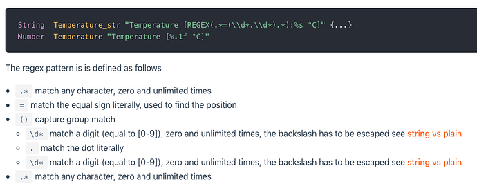

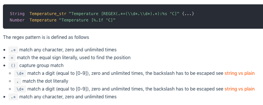

The docs for the REGEX transform imply (In the examples given) that in a grouping the . is a literal . Not that I believe it, that’s just weird, but given it doesn’t understand I’ll fight that one when I actually get some data flowing to test it.

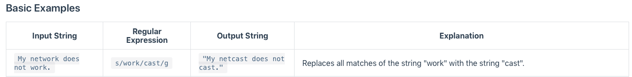

I’m not sure why the example has .* at the start and end of the regex or why you say it has to match the whole string. Normally that just a waste of processing cycles in a regex. e.g. (.MATCHME.) should be the same as (MATCHME). And the example for replacement even has a regex that doesn’t match the whole string. e.g.
And it understands anchors… So if there’s implied anchors (i.e. from your statement that you have to match the whole string) why would there be an option to add them… They’d be superfluous. Except in example 1 of course.
